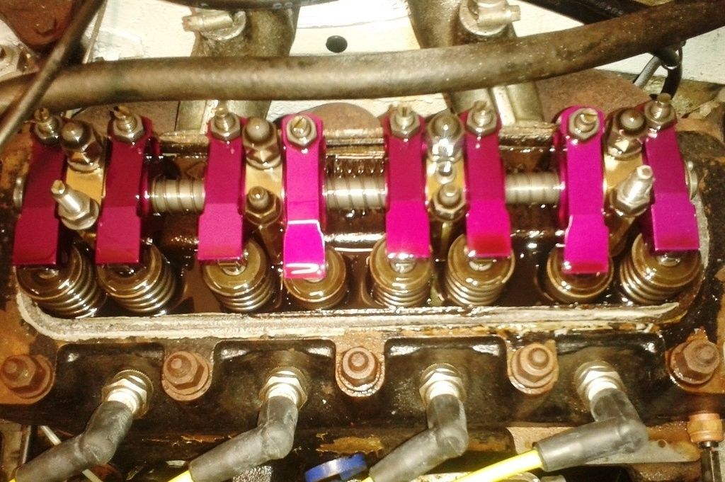

I finally got around to checking my valve clearances and found a range between 18 and 27 thou. Anyway I was hoping that the rockers would have some identification on them - but no. I think they are 1.5's.
Are the purple roller tip rockers colour coded to identify there ratio? The mini websites are selling purples as high lift 1.5's.
PostPosted: Fri Jun 19, 2015 2:45 pm
I think they are 1.5s.
Do not set clearance to less than .019", and check the gap between spring coils @ full lift.

I got purple ones from Minispares, they are 1.5. As doc said, watch your spring crush.

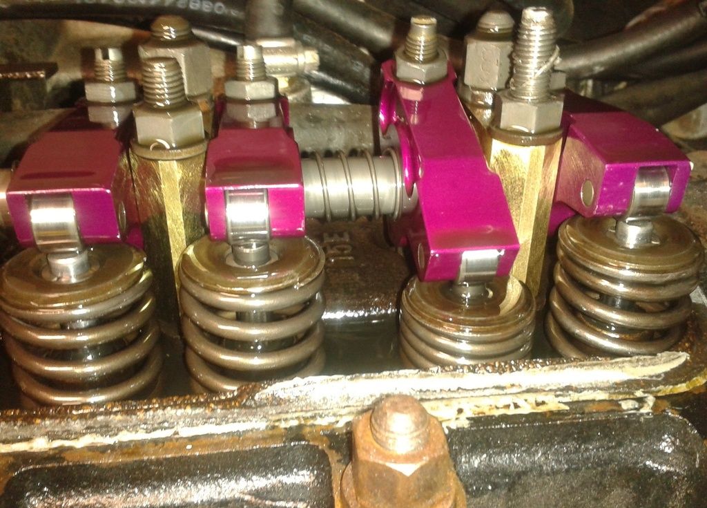

I took a gamble they were 1.5's and set them to 19thou. I forgot to measure the spring crush but in the photos I took there looks to be a decent gap. Not happy it only has single springs. Will be buying C-AEA526 on my next order I place.

Thanks for the input. I checked the coil bind today and its pretty close. About 20 thou gap at the base, 10 thou on the next coil. Top 3 coils are touching. Will be taking it easy until I put in the new springs. Went to check the lift - found my DTI but have somehow misplaced the magnetic base.
