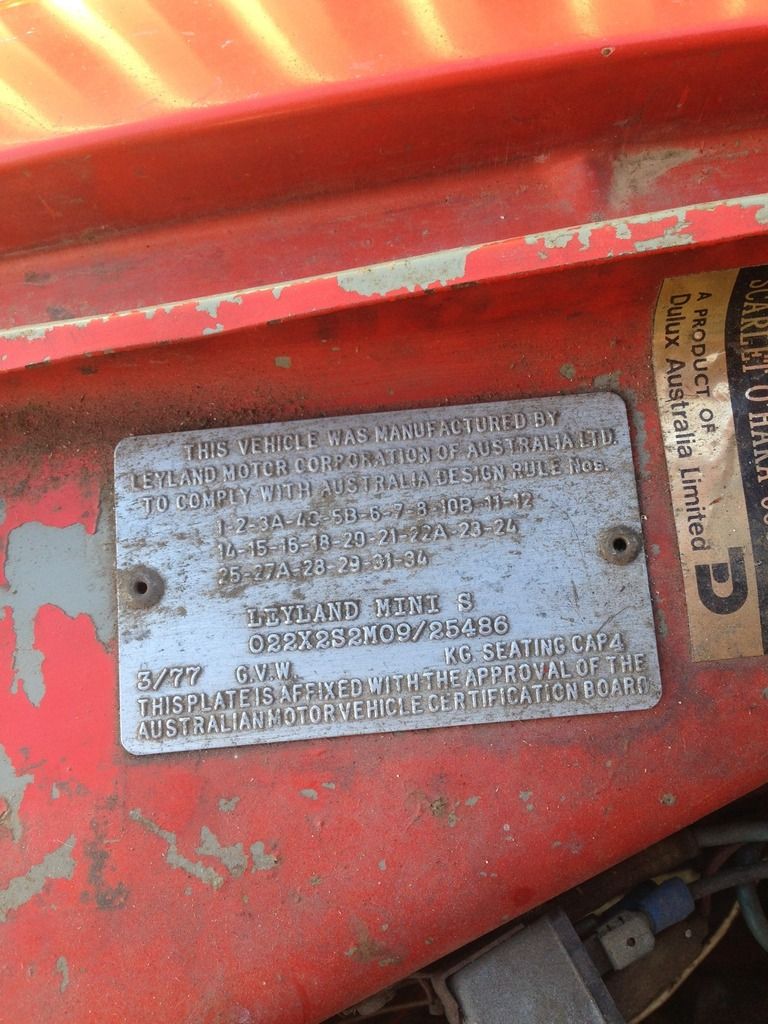

Lewis - if you post a pic of the ADR compliance plate you will get an explanation of exactly what model it is, and some advice on how to best get it back on the road. As mentioned above, the presence of the spot lights means it could be an LS. Are they Marchal brand?

tried adding pic of the plate but says the board attachment quota has been reached

there's the plate
Image tweaked by mod so it displays

@ Winabbey this document says all cars will use the 1100 engine but based on the vehicle plate above (M09) isn't this car a 998 ??
I don't know. The press release was April 1973 and the ID plate is March 1977 so the vehicle specification may have changed in the meantime.
John Sneddon will know.
PostPosted: Thu Mar 26, 2015 3:18 pm
They had to drop the 1100 motor when Zetland closed at the end of 74 and used imported 998 motors from the middle of 75.
