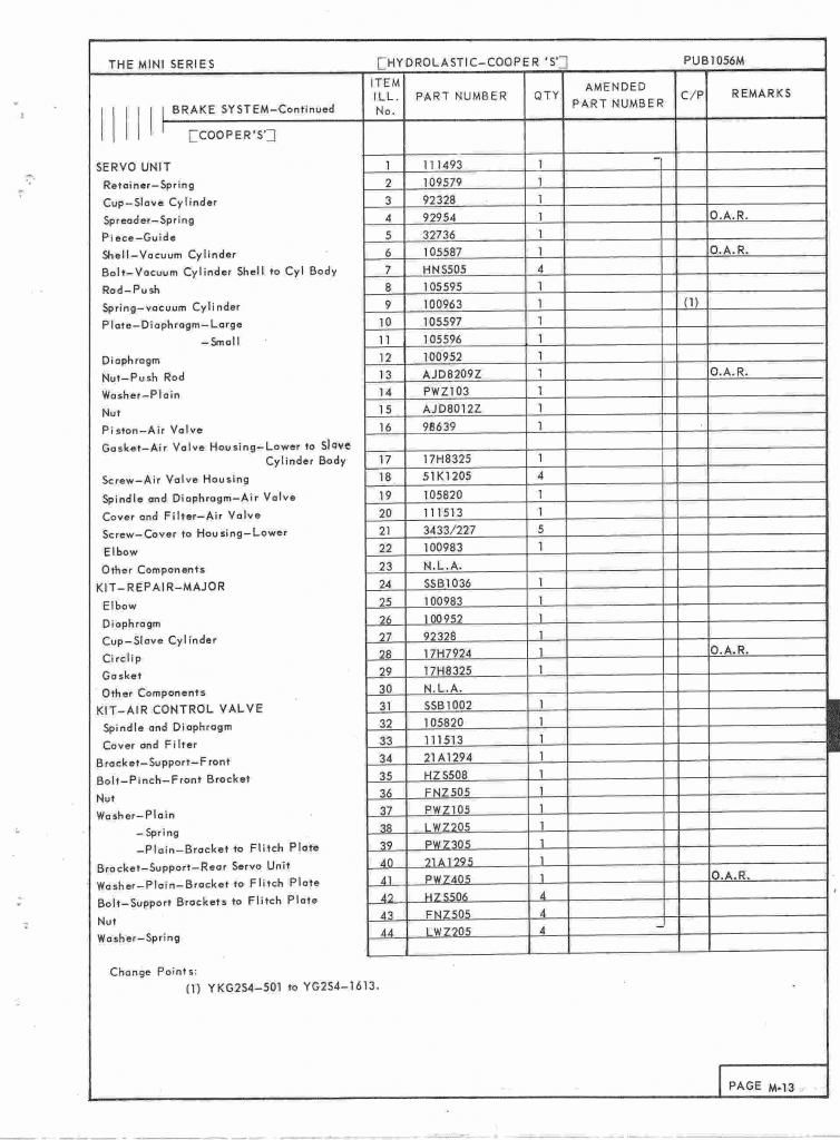

There's been lots of discussion about when the K was dropped from the MK II Series cars. Based on various company documents I've seen I believe they used YKG2S4 until the introduction of the compliance plate in January 1970. The page below is from the MK II Series parts book PUB1056M and shows the Lockheed booster being used from the first MK II S (car 501) until car 1613, which is around Feb/Mar 1970, when the PBR VH-44J unit replaced it. You'll see both forms of body prefix are referenced in the change point data at the bottom.

So that means every 1969 MK2 S should have the YKG2S4 stamped on the Rad shroud. I haven't seen that. Does anyone on here have a genuine 1969 MK2 S that can confirm this?
Not necessarily. Different parts of the company sometimes used different versions of codes and other parts references. I'm simply pointing out that YKG2S4 was used as prefix in some BMC documentation, such as the parts book. Whether some early 1969 cars were stamped that way or not remains to be seen.
