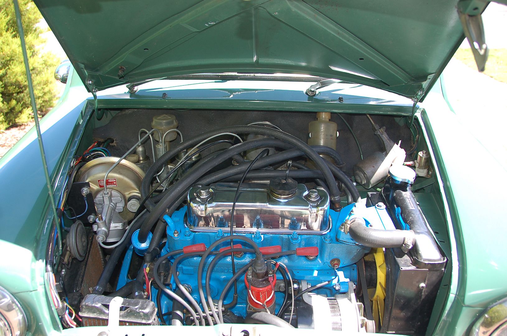

How was the Mk1 booster finished when they came from the factory?
Black body with plated bits, or grey hammertone, or what?
I did my last one with a black body and silver grey hammertone bits.
Looks OK but is it period correct?

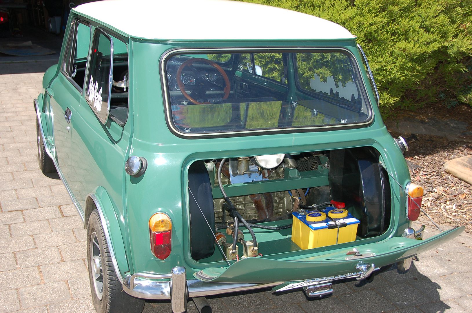

I love that engine bay. I love the other one too...

Upgraded Engine bay :D
But any comments on the Lockeed booster finish?

Mine looks like the top photo.
