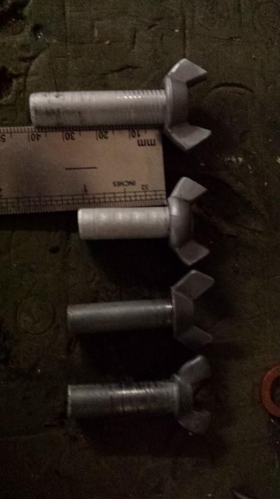

I noticed last week that repro wingnuts for the twin SU airboxes were being made available again. I couldn't help but pick a set up to throw in the parts box.
We all know that you can make a set in a pinch by cutting down clubman wingnuts, but they don't look right, and aren't that common anymore either. Not a sustainable practice anyway.
The news however is both good and bad:
The good news.
Yes they look fairly OK. They are much stronger in the "wings" however, and so show this in being quite thick. They also look somewhat like a cross between the two types of wingnut found on our cars. So yes they fill a need.
The bad news.
They are cut to cut to suit the 6mm shorter english airboxes. So unless you have a late GT airbox, or an english airbox, then its a struggle to get them to engage. Mine didn't want to engage at all. :x
Oh well, the best laid plans of mice and men...
To the left is the two types found on twin SU airboxes. The short repro is on the right.

Yeah, I didn't find out till the otherday....
Its not insurmountabe however. If you manage to source a pair of 850 carb throats, many of these came with the vent port reliefs machined into both sides. Or you can get a standard throat and file a relief port out yourself (or use a dremel).
From there, you can cut the long air cleaner mounting thread down to suit, but make it 1/2 or 3/4 of an inch longer than the throats on the carb are now.
Not a very difficult job at all.

I've had a chat to the maker. He's able to have them made up to a longer length.
He will let me know when they're available again.
PostPosted: Mon Dec 09, 2013 5:26 pm
The seller was good enough to send me another set, this time a little longer (12mm).
These fit pretty well, but are now a little bit too long needing only 6mm. Never mind...they fit just fine going down the full length. The next lot he is making up will be the 6mm longer type.
The repro is on the right. Original on the left.

I've got a couple of air horns/elbows to suit my twin carbs. They look to have the right length of thread coming out to do them up onto the air filter case
And here is the collection of wingnuts. Left to right they are 30mm, 26mm, 26mm, 32mm, 55mm, the far right is the one from my HS4 filter case
The "pointy" one on the left is the only one thin enough in diameter (8.9mm) to go through the lid of my Mk2 air filter case (holes are 9.3mm). The two 26mm ones are 9.4mm in diameter.
So... are the 26mm ones long enough if I decided to embiggen the holes in the filter case, or will they be too short? The 30mm one fit on fine with a good couple of turns with the rubber seal and washers. It is a Mk2 filter case, the majority of the body is 48.6mm thick
Originality doesn't matter too much (A Mk2 filter case on Mk1 carbs on an 1100 in an 850) but it'd be good to have matching ones at the very least.
