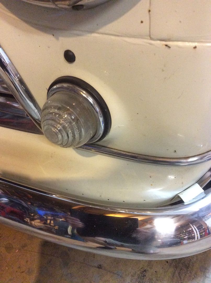

Having just read the wanted adds where there is a query about the originality of the front end.
I have a 1964 (novemberish) and would like some opinion if it is period correct, not that I would change it if it wasn't.

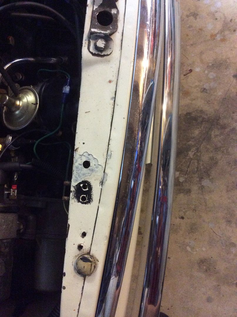

Top bonnet mating panel with some spare holes and two studs.
Blinker and raised support.

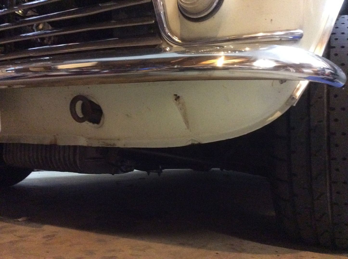

Front apron although missing is the front bumper mounting angle. I'd love the angle if someone has one.

Those studs are for mounting the fresh air duct for the heater.
PostPosted: Sun Jun 28, 2015 10:40 pm
yes, that front is original

What's the black dot between blinker and headlight?

I would have thought a late 64 would have had the brake cutouts on the front valence?
PostPosted: Mon Jun 29, 2015 10:17 am
nah, changeover period was '65

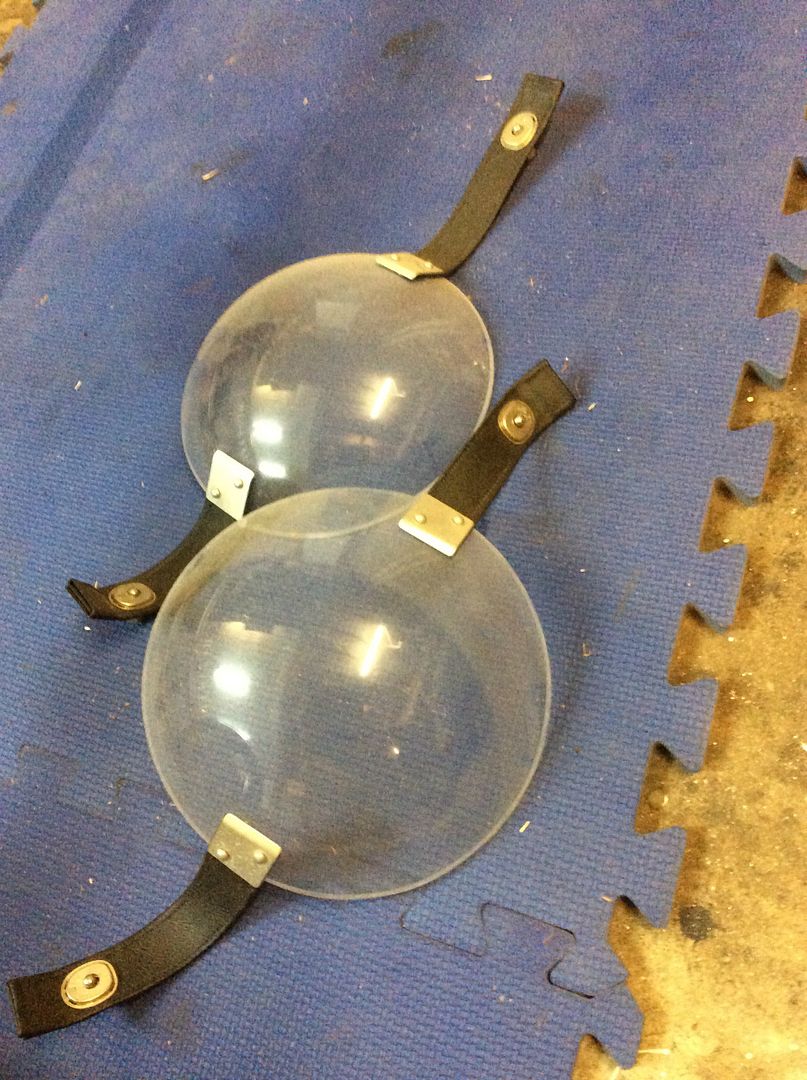

It had a set of Domed plastic headlight covers on it. I still have them.
The Black Dot is a rubber plug. I'm yet to weld up the holes and touch up the paint.

PostPosted: Mon Jun 29, 2015 9:25 pm
simon k wrote:
I am seeing some very strange things, as my November 1964 850 has brake cutouts. Body number 59367.
I am certain the front panels have never been changed...
Whats the go?!

My body number is 55777, so earlier than yours.
When I enquirer on here what year/month it was I was informed it was likely November 1964 ?.

Bubbacluby wrote:
Phil 850 wrote:
Phil
Thanks Phill
These
PostPosted: Mon Jun 29, 2015 11:12 pm
Posts: 1125
Location: Barossa Valley, SA
It had contact lenses? :shock: Did you get it glasses instead?
I believe they maybe for the horn in the early days
PostPosted: Tue Jun 30, 2015 1:40 pm
Posts: 1170
my 62 850 had the horn mounted on the studs.
as for the front bar mounts, never seen that before, mine has a full length seam with no notches at all as no overrider as std
