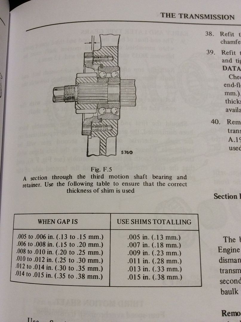

I presume your talking about the third motion shaft bearing retainer as per the image below.
I can see where it may be a close fit with a larger pinion.
I presume this retainer has a large section cut away where the crown wheel meshes with the pinion.
 Post subject: Re: Final drive fitment
PostPosted: Sat Jul 25, 2015 7:21 pm
Yes that is it.
As long as the retainer's bore clears the pinion's teeth by 1mm or so it is fine. If not, bore it until it does.
If you have access to a lathe it is a 5 minute job.
4 synchro remote and earlier retainers need a bit more metal taken out to achieve this.
