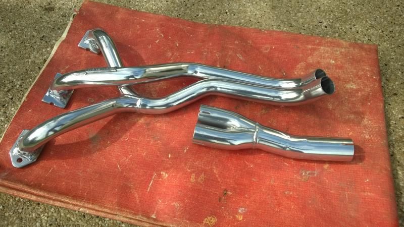

Had mine done by HPC in September last year. Three piece maniflow LCB cost $288 inc return postage and GST to give you an idea of cost. I mailed mine to them and got it back a week or two later. My last set done by them were good as new for years.

The sad part about ceramic coating is that the extractors will never look as good after the first time you start the engine... :(
But it is much better than heat proof paint.

Maybe not as shiny but my last set were still silver with no rust after a few years of daily driving. I did wonder though if it would have looked better in black.
