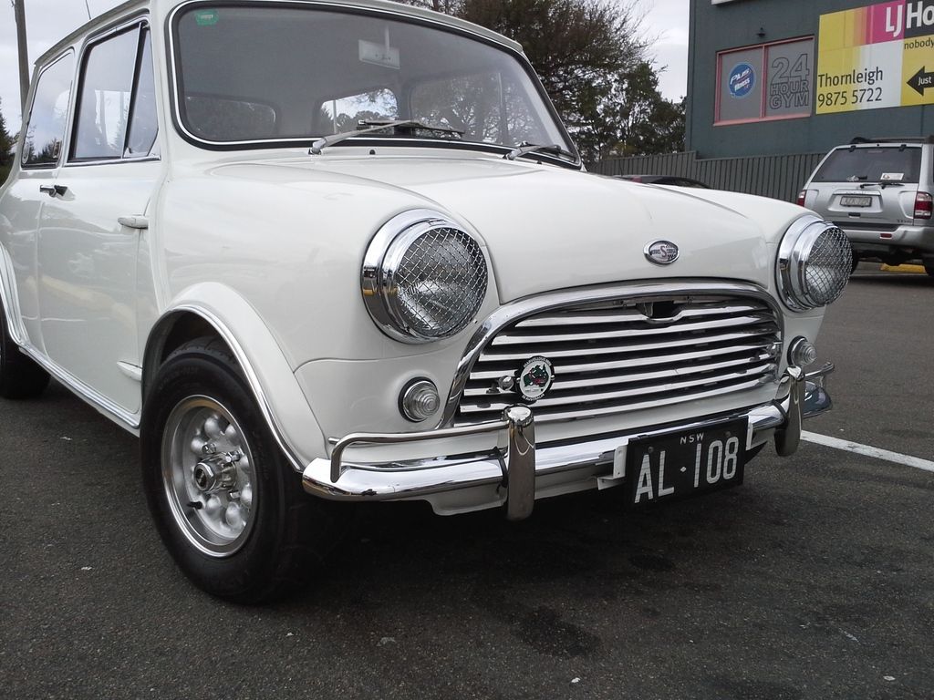

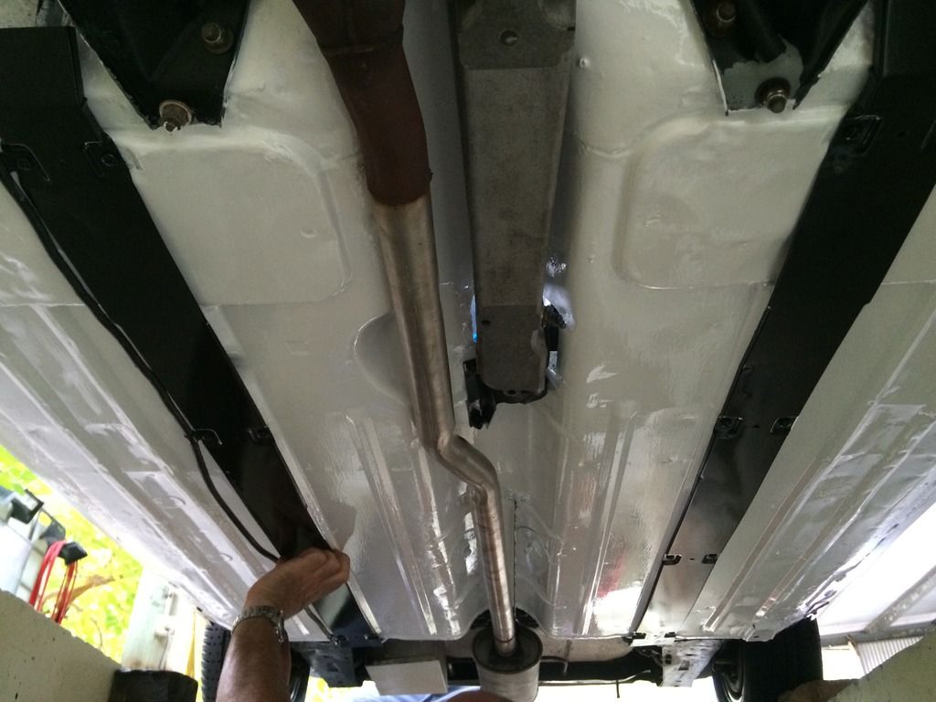

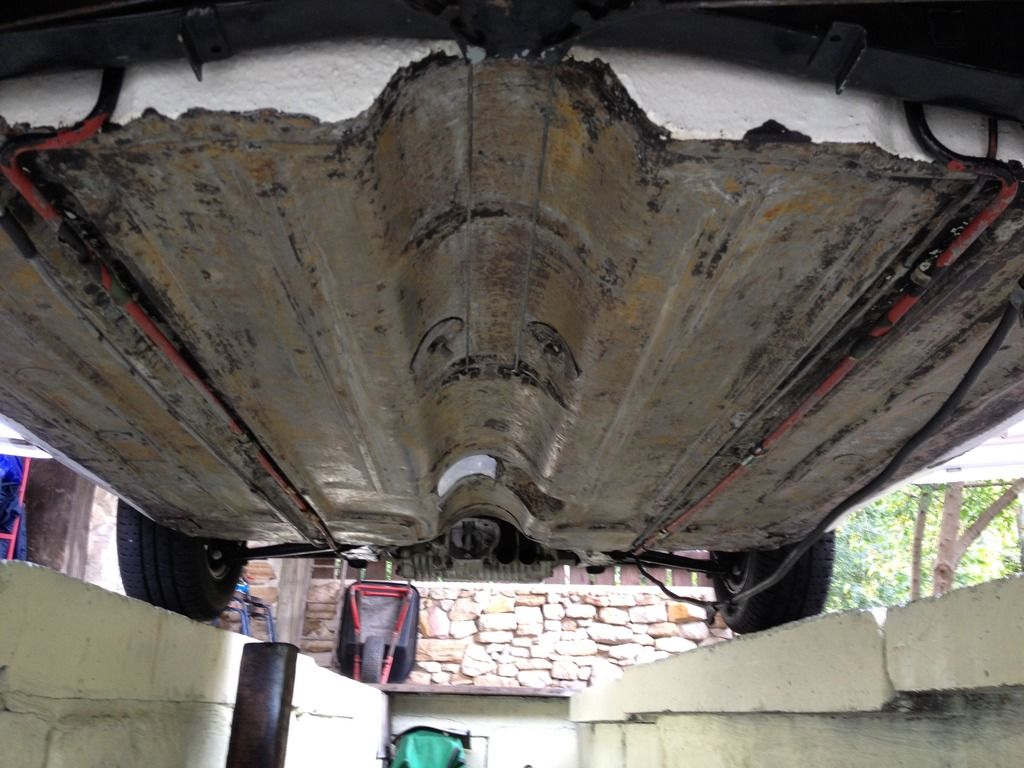

In Winabbey's post is a photo of my car and hopefully here are some before and after of the underside. The stripped photo is when it was prepped with the por 15 metal ready treatment and ready to undercoat, then there is a photo of the finished product. I think it came up really well. The floor is solid as, no rust.
PostPosted: Mon Mar 23, 2015 5:54 pm
That's some hard work right there. Came up a treat. Where do you think the holes came from? Dents or corrosion?

She is a nice looking car.

Thanks gtogreen, i'm really liking that photo of the top side its a good angle.
And Mick, the holes or hole, definitely not rust. There was some damage to the floor around were the wheel arch met the floor,not bad damage but possible source. The other place were water came from was the the recess for the jack. So i made sure i got some sika body sealer in there and painted over it.
I think those covers look good black! I'm trying to work out now how to wash under the car, haha.
Matt.

the floor came up fantastic.
