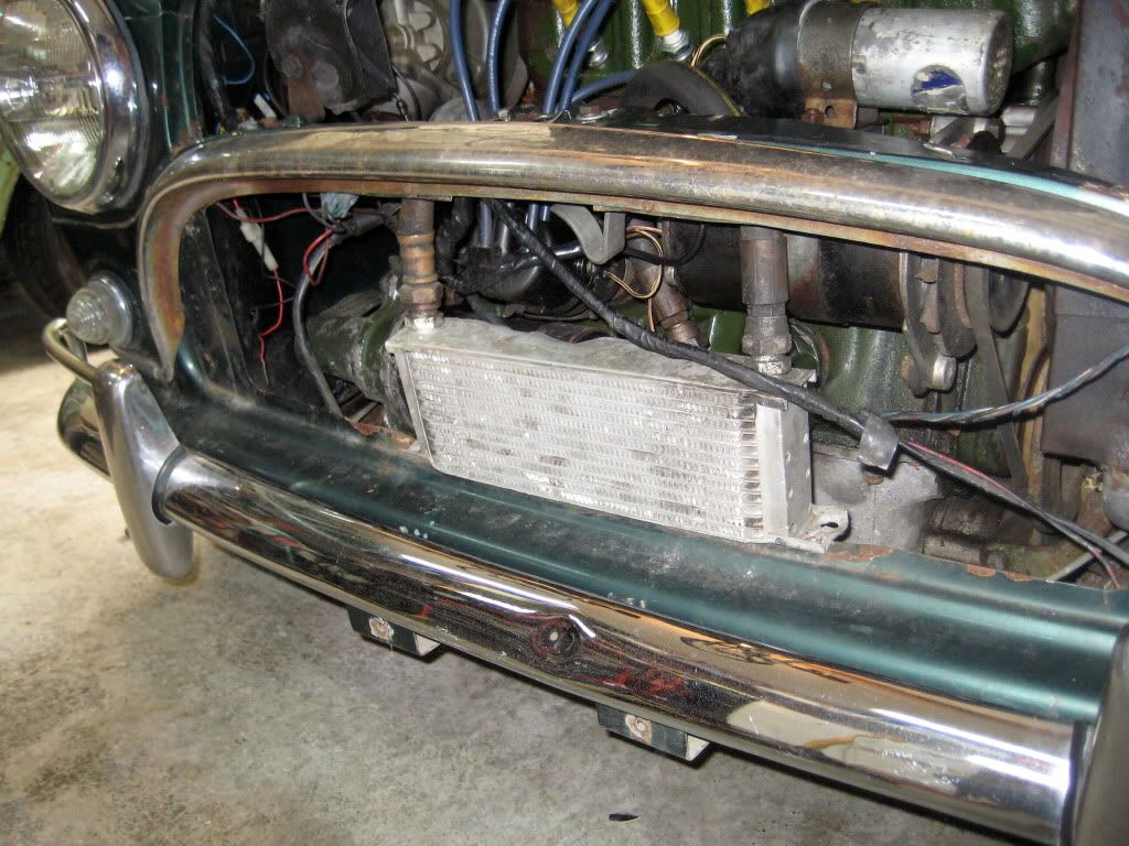

simon k wrote:
I don't remember what it looks like when mounted
(that's what she said)
Here's a grubby pic.
Skype: shocker2000

So is there meant to be support brackets going down to the lower edge of the valance? Mine is just mounted on the folded section using 2 of the 4 screws on the base of the cooler.
 Post subject: Re: Oil cooler
PostPosted: Tue Aug 25, 2015 12:25 pm
yep - something like this: https://www.minispares.com/product/Clas ... A1794.aspx
they fit with the long flat facing forwards, inside the beaver panel. Mine (originals) have a double layer on the rearward half of the short flat and the forward half as a single layer. The forward half sits under the apron lip and the edge of the double layer butts up against the edge of the lip, making a flat platform for the cooler
