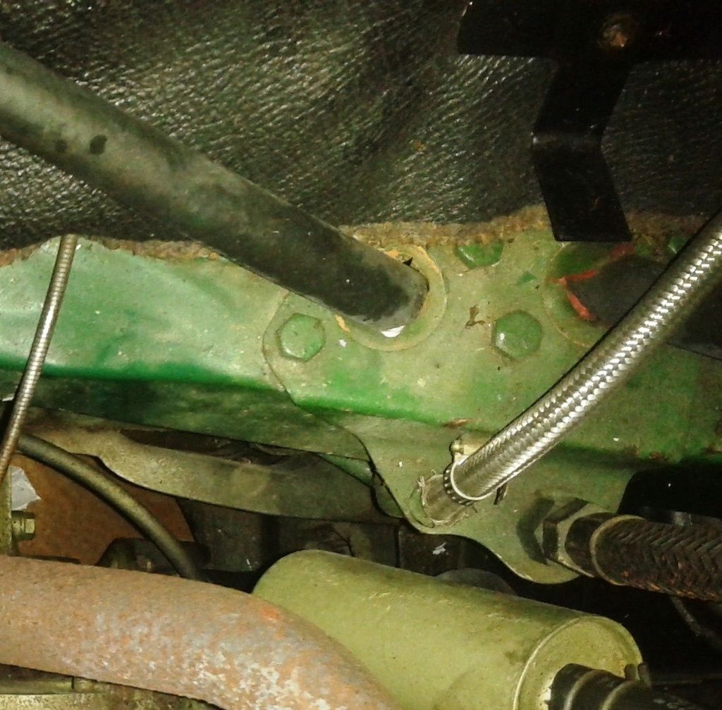

My car has rubber flaps where the heater hose enters the cabin. Not sure if its original though.
Here is a photo anyway.

Mine is different. Hoses are a tight fit thru plate.

My MK1 has a gasket under the heater hose plate and the hoses are a tight fit. There is a gasket on the other plate under the master cylinders as well.

Yes there should be a rubber gasket to seal the hose gaps through the plate.The last of the rovers used a rubber grommet to do this, and they are available but do not fit an early car like our own (I tried). See here: http://www.minisport.com/34g3651-rubber ... -body.html
The answer is to cut a piece of thin rubber to act as a gasket between the plate and the body, and with a punch or by cutting a circle, cut holes smaller than the hose diameter to seal the gap.

OK, Thanks for all the photos and advice. I think you are all on the right track. My heater tube to radiator hose is about 3mm smaller than plate hole, certainly doesn't look like Phillb's. I have also found the same hose has worn to half wall thickness from rubbing on L/H bag Hyd hose. I'll pull it apart and replace hoses and make up some neoprene gaskets. (might want to check yours Phill)

Mine seems to be 2 plates, the bottom being the bracket for the hydro and fuel hose, then a smaller plate on top, I assume there is a rubber gasket in between the 2 plates.
Thanks I'll double check my hoses.
