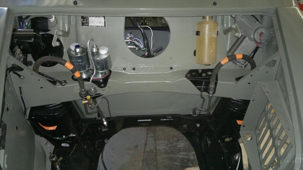

Hi All,
Wife and I have just purchased a 64 deluxe which I believe is supposed to have hydrolastic but being until now I have only had Mini's on dry suspension setups didn't really know what to look for to tell the difference. If someone could shed some light on this and share some pics that would be great . Also in terms of topping the hydro fluid up and the pump needed for this is this something that could be done at home or would it need a trip to Mini Classic?

These hoses painted with the orange bands are for the front Hydro Bags
The bags look like this and are situated where the rubber cones go.
There are solid pipes under the boot and 2 service valves for pumping up and letting the fluid out.
