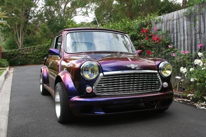

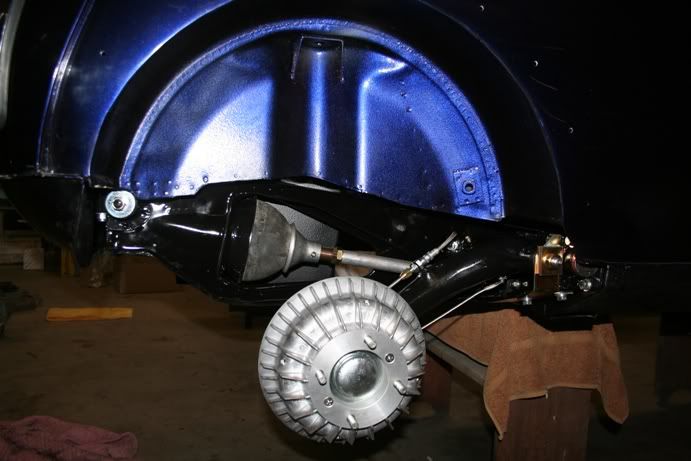

I have 13x7 on my mini with 8.4" front disks and normal size stepped rear drums and the only thing I think you will need to worry about is how big the flares will need to be. I also believe spacers are illegal? Or have I misinterpreted your details?

My rear drums are finned but are the same width as Cooper S stepped drums

michaelb wrote:
Yes it is Smootha ride kit
And yes very happy
It rides similar to hydro car and soaks up the Sydney pot holes very well
I think rear donuts are close to standard but fronts are much bigger in height.
Took a while to settle down to a good ride height but was ok after about 12 months
Thanks for the info Michael
I had just ordered this kit when I saw the photo of your car and was interested in your experience.
Phil
