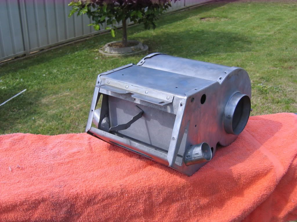

I'm currently refurbishing a fresh air heater for my 997 Cooper (as per Flutes How To) however the replacement heater matrix does not fit, the spacing between the replacement matrix inlet/outlets is smaller than the holes in the side cover for the heater??? Very annoying, unfortunately I do not have the original matrix.
I note on the minispares site that they sell an earlier matrix where the hole spacing was greater? Anyone else come across this issue?

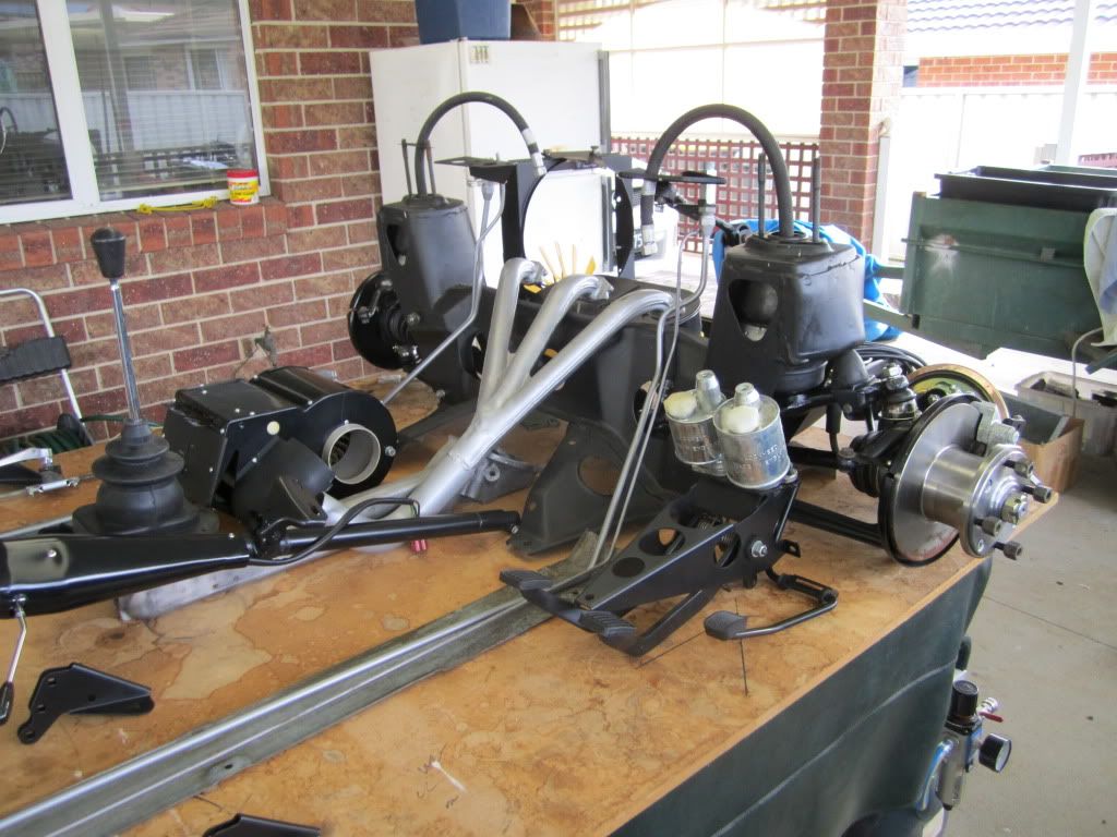

I too had this problem
there are two types of side plates
in the second photo you will see that it has a PVC air inlet held in with rivets
this type has the holes closer together than the one with steel inlet
you could try and get the other side plate , which is the fan end or desolder the inlet pipes off the heater matrix and reposition them

Yep, exactly the same as mine, I have the steel inlet. The correct core is available but expensive at£111 plus postage.
