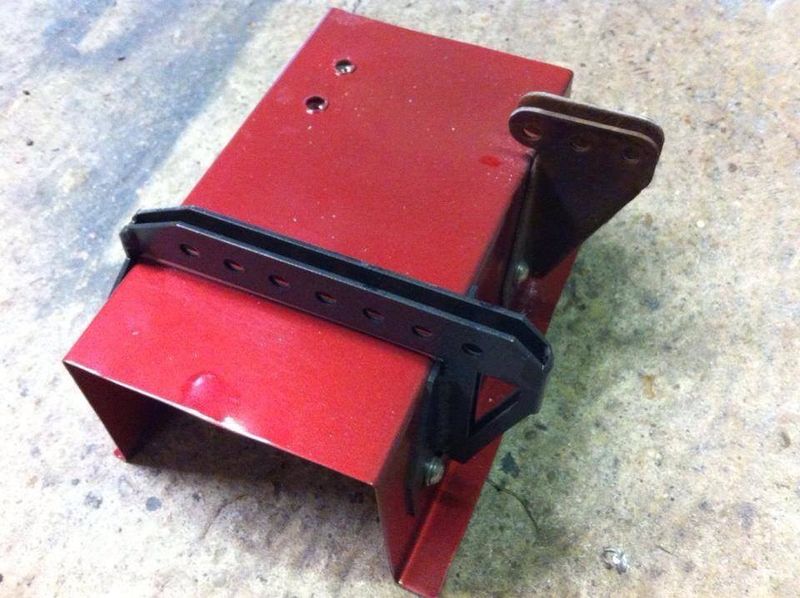

Anyone ever used these? From JB fabrications in the UK £35 a pair posted.
Might be better then this bloody setup?
I'm not really a fan of these stock seats... Might have to buy another set of race seats... No support... Just slide out of the stupid things.

I so want them! How did you find them? I cannot see anything on their website?

Wonder how stock seats would lock down at the back on that rod that bolts through the floor being further back on the last hole

Are you talking low back or high back seats?
It's on there face book page.

Is it bolted into the back of the crossmember aswell or just sits over the back?

Kinda just looks like it sits on the back side?
PostPosted: Sun Oct 11, 2015 11:56 am
They're that nicely made that I would consider tacking them in permanently if I had a need to have them.
....Or putting captive nuts into the back of the cross brace.

I would drill a 12mm hole right through from front to back, and braze a 12mm steel rod in there, tapped 1/4" UNF both ends.
It's how I fix captive nuts that have broken out and gone awol (but I just tapped the front).
