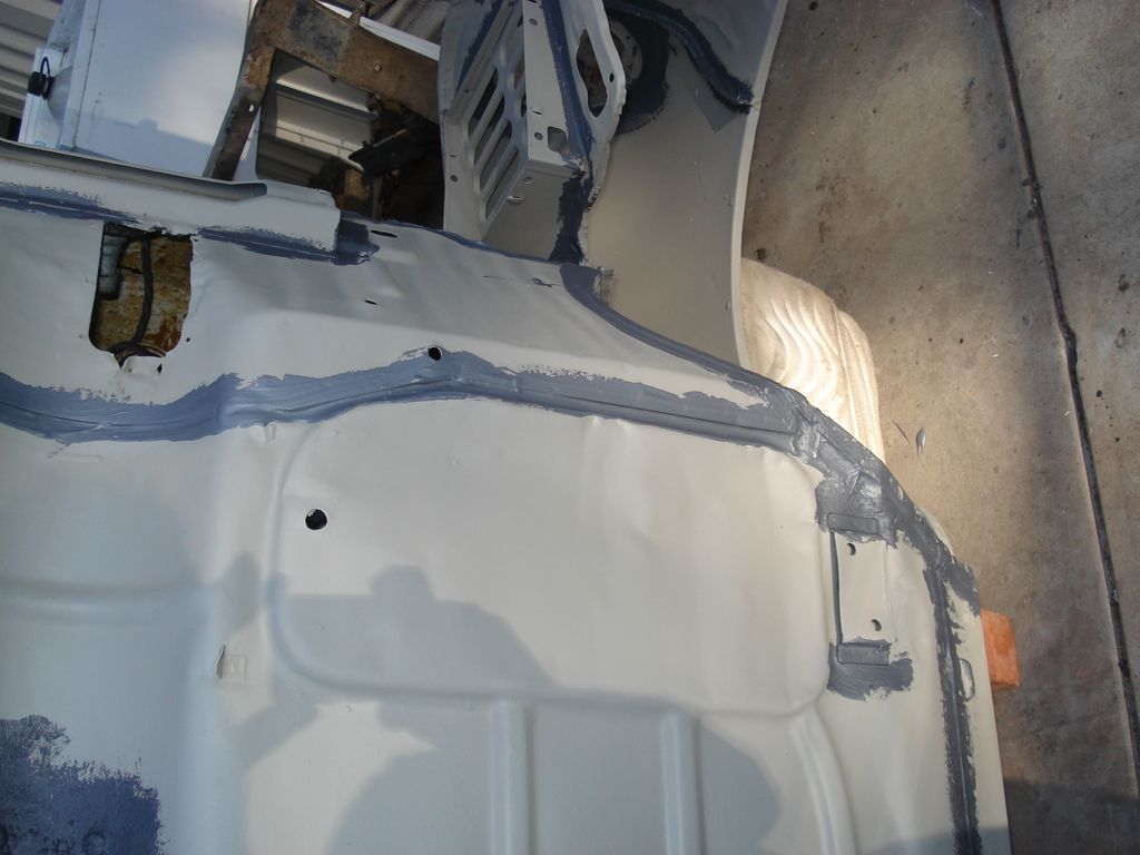

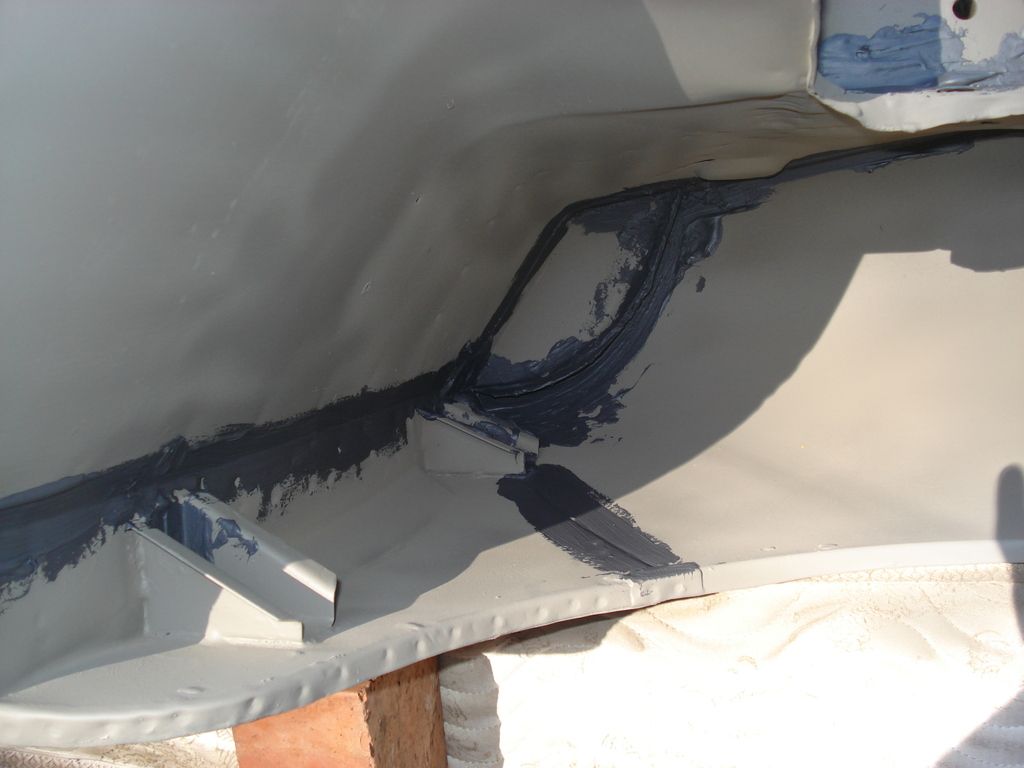

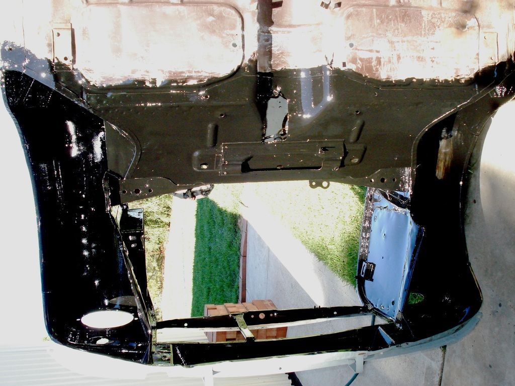

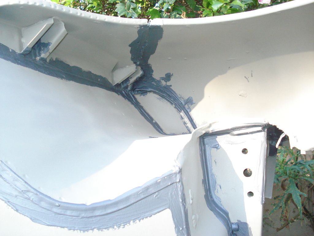

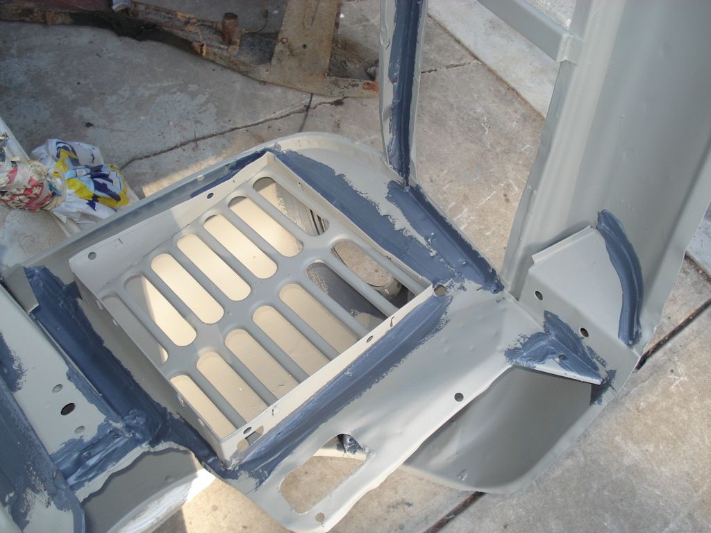

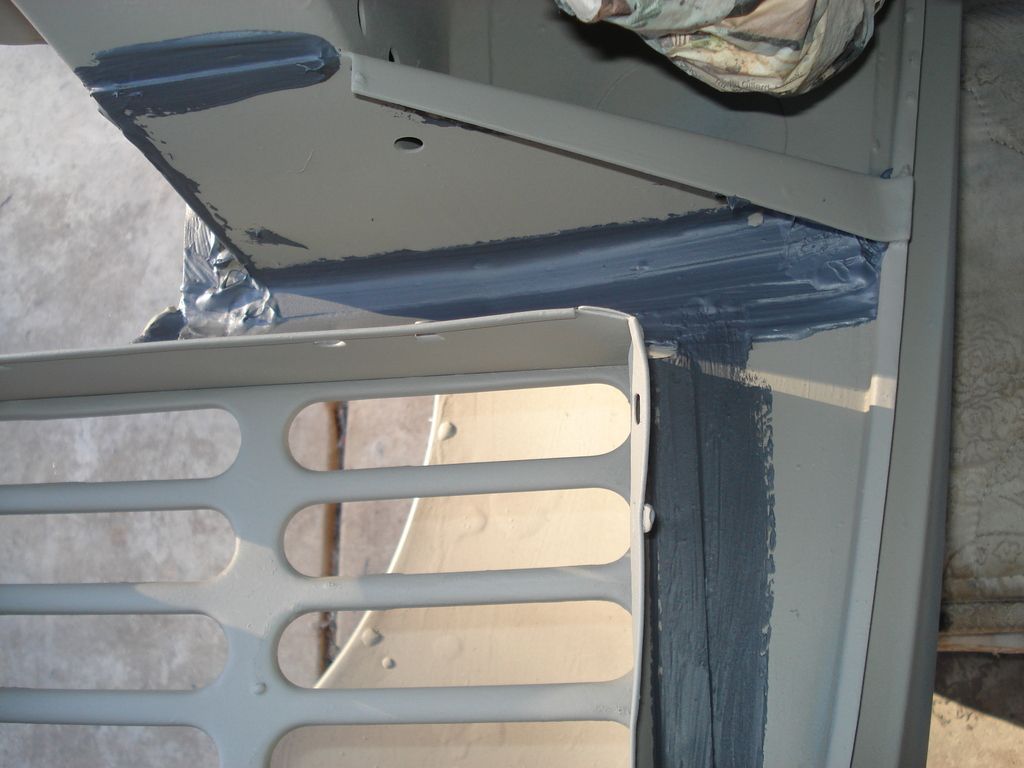

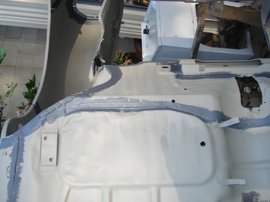

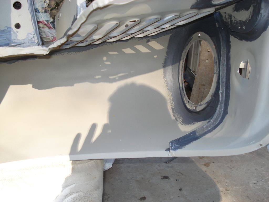

If you're taking it down to bare metal (ie the entire engine bay), KBS Rustguard (Aussie POR15) works a treat over the entire underside of the engine bay bulkhead (and in fact on all the underside bits!!). Follow up with a coat of primer whilst it is still tacky and then paint rubberised seam sealer (buy from an auto paint shop) on all the seams. That Tassie weather won't get anywhere near the metal once the topcoat goes on!! Here's what I did:

Nice work :) how many litres do you think u used for the engine bay ?

PostPosted: Tue Oct 13, 2015 4:23 pm
Posts: 384
I used around 250 ml of KBr rustguard (3 coats) and around 150ml of seam sealer for the engine bay so surprisingly not much!!
