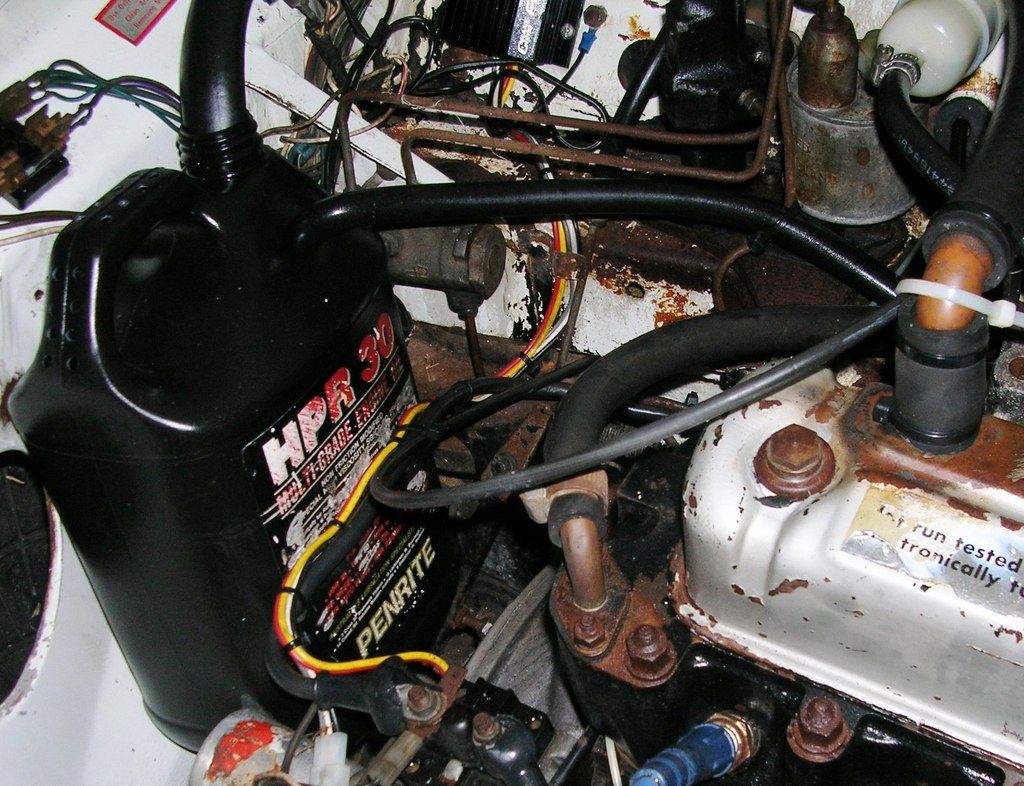

I put a PCV on both of my inlet manifold take-offs. My car has 2 rocker cover breathers only.
One is plumbed into the intake manifold through a PCV and the other goes through the charcoal canister first then through a PCV to the intake manifold. The PCV valves and hoses I got from the wreckers for $5.
Originally it had a 5 litre oil container as a catch can vented to atmosphere.

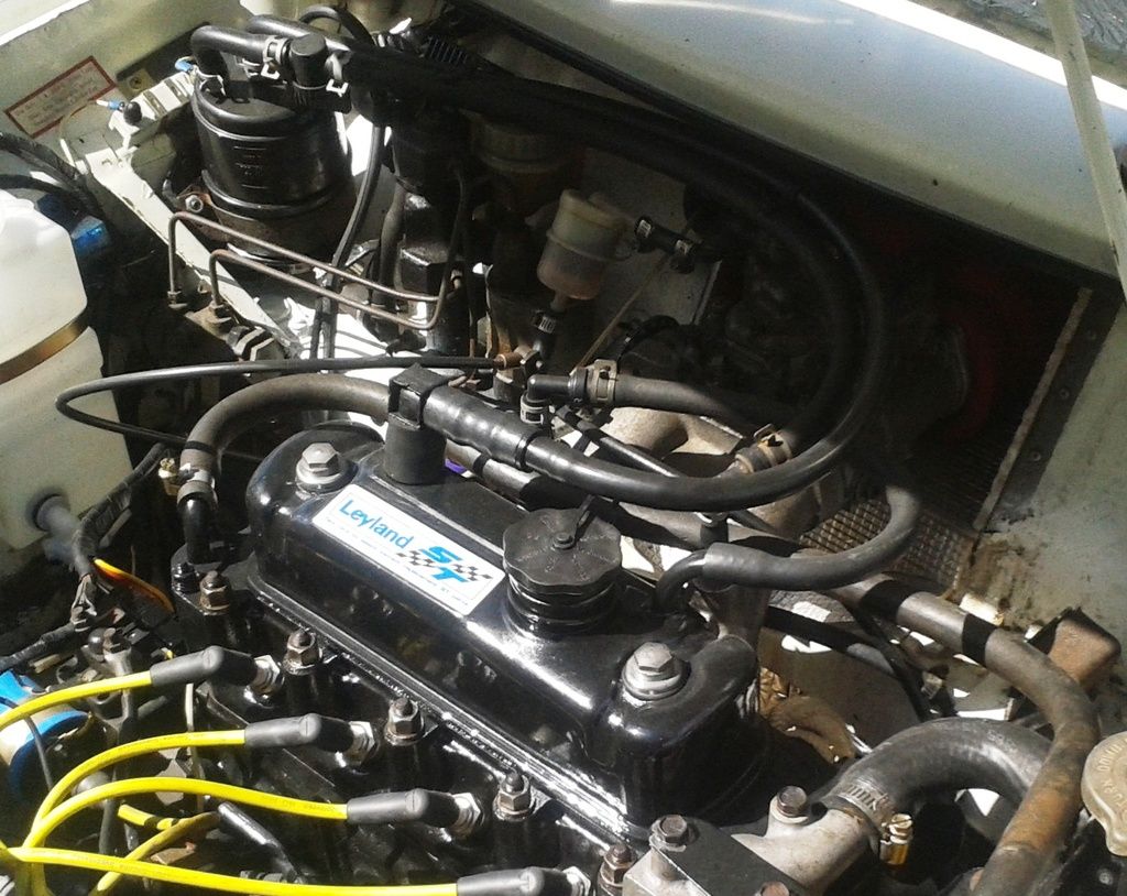

re the Weber manifold- you can put the PCV valve into one side only. However this buggers up the idle mixture, which you then need to set richer on that side to compensate.
I used brass fittings to add a 3/8 bore balance pipe, with the PCV valve into one side, and the vacuum booser the other. The PCV valve I'm using is a Toyota style one, from the rocker cover. I have no flywheel housing or timing cover vents.
The other fittings you can see are the water heating, which I added to eliminate carb icing on the freeway.
Note the PCV valve is designed to pull a slight vacuum in the crankcase. If you do not restrict the air inlet, this won't happen, and it's more likely to pull oil thru the PCV valve from the fog existing down there. The breather can is not an oil separator. It's a flame trap.

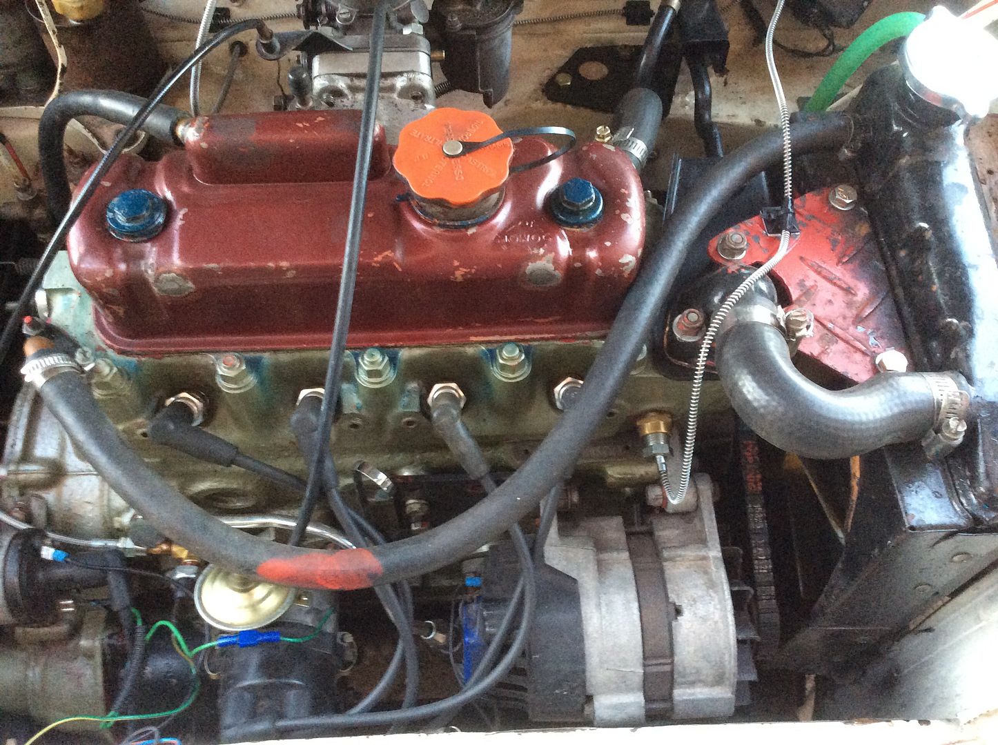

My 1100S has only one breather.
This is from the rocker cover. The hose just dangles down beside the flywheel housing.
Nothing ever comes out of it (well, no oil anyway). This is how my professional mini mechanic did it.
