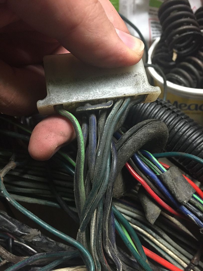

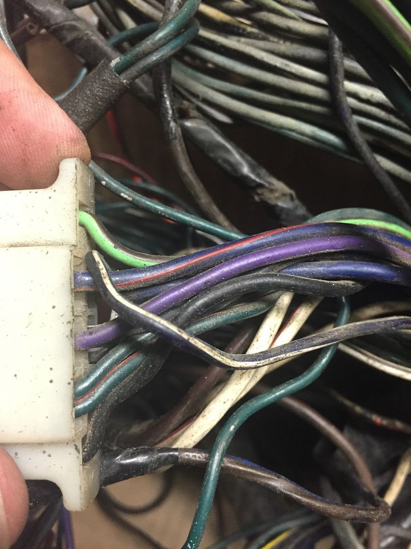

Don't have a stalk laying around to line it up with for you, but here are some shots. I assume this is the plug as it the line green wires link up to the flasher can. No brown wires here but there is a black and what looks like a black with a brown trace? Needs a bit of a clean up!

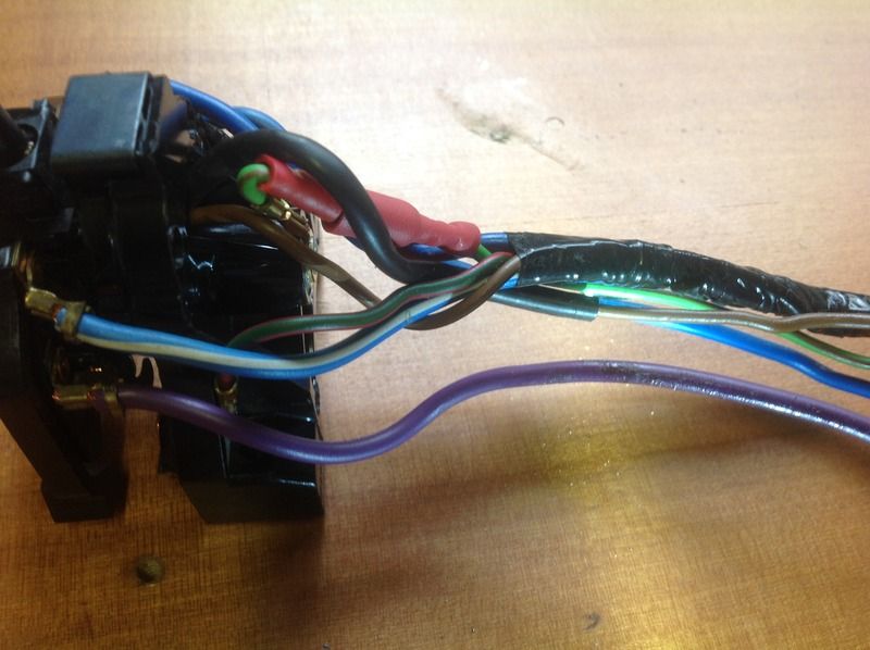

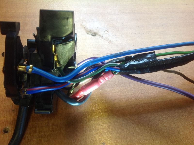

The offending stalk
The other side.the black shrouded brown wire is in the middle of the assembly and has the wire mesh earthing sheath on it. The other brown wire is in the centre of the assembly and has a black trace.
