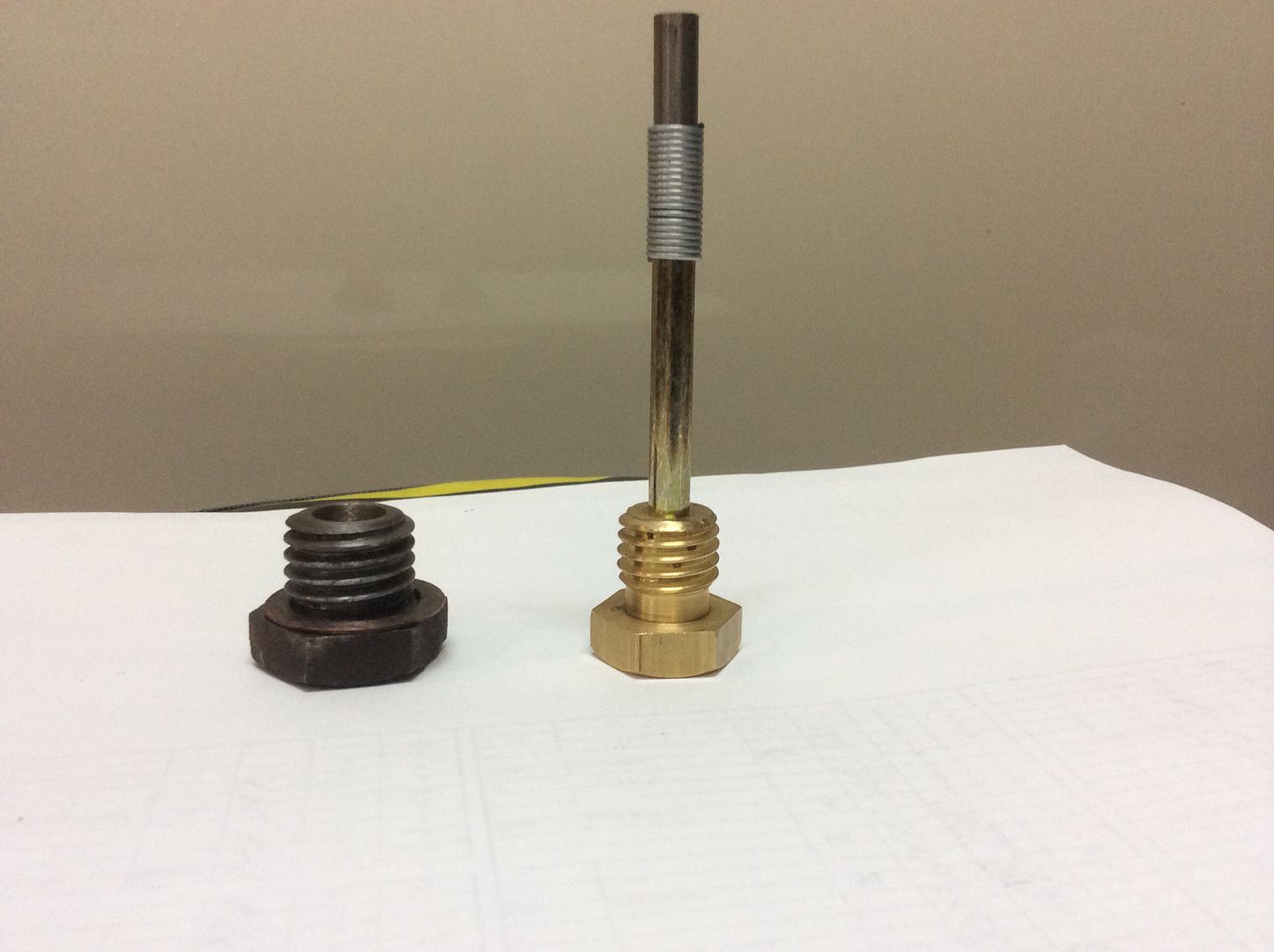

I went to fit my new long magnetic sump plug but it swims around in the hole ?
The original plug is 3/4" 10 UNC and the magnetic one is 5/8" 11 UNC.
Which one is the correct size.

The one that fits!

Someone has stripped the thread and tapped it bigger. 5/8 was original.

The old plug has a 6mm hole drilled down inside it.
I'm tempted to cut the shaft off the magnetic one and drill the hole a little bigger and drive the shaft of the magnetic one in and then refit the magnet to the end of it.
Does this sound feasible ?

Just make up some epoxy resin or something like that to glue the shaft/magnet into your plug.
Just try to keep it straight.
Or did you say that the old plugs hole is smaller then the shaft on the new plug? Doesn't look it in the picture but if so then just do as you mentioned.

Works a treat.

I don't trust epoxy. If it's not prepared/mixed perfectly the results can be poor.
I'd hate to have the magnet come loose and leap onto the gears :shock:
Mick
Yes, I think the "press fit" option is better.
Is a magnet really necessary. I'm only fitting one because I can and others do as well.
Follow the leader :roll:

Magnet is a good idea. Press fit the one out of the new plug.
