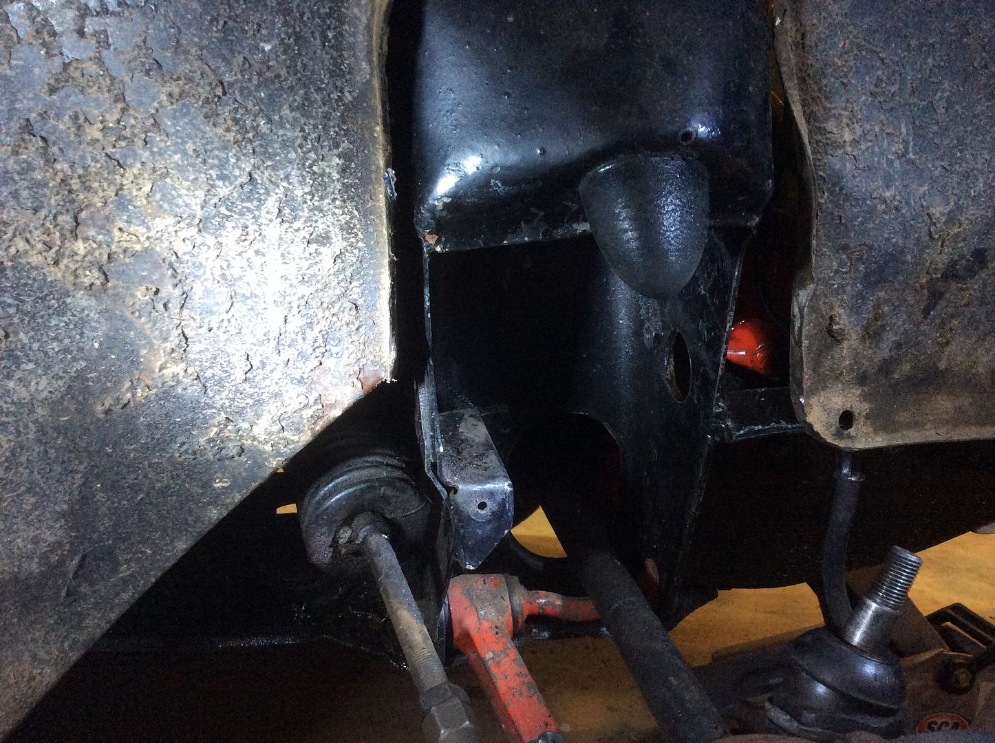

This is what your mini looks like without the arm.

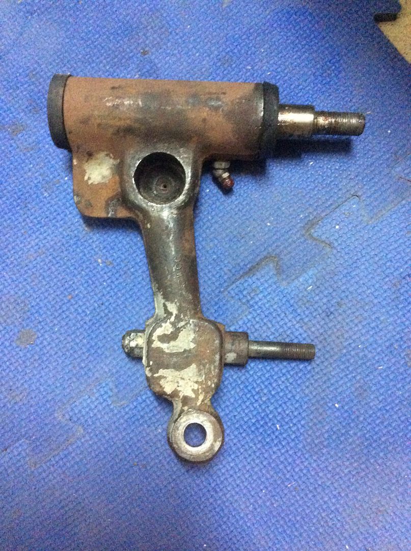

Set up the arm like this with all the bearings and seals

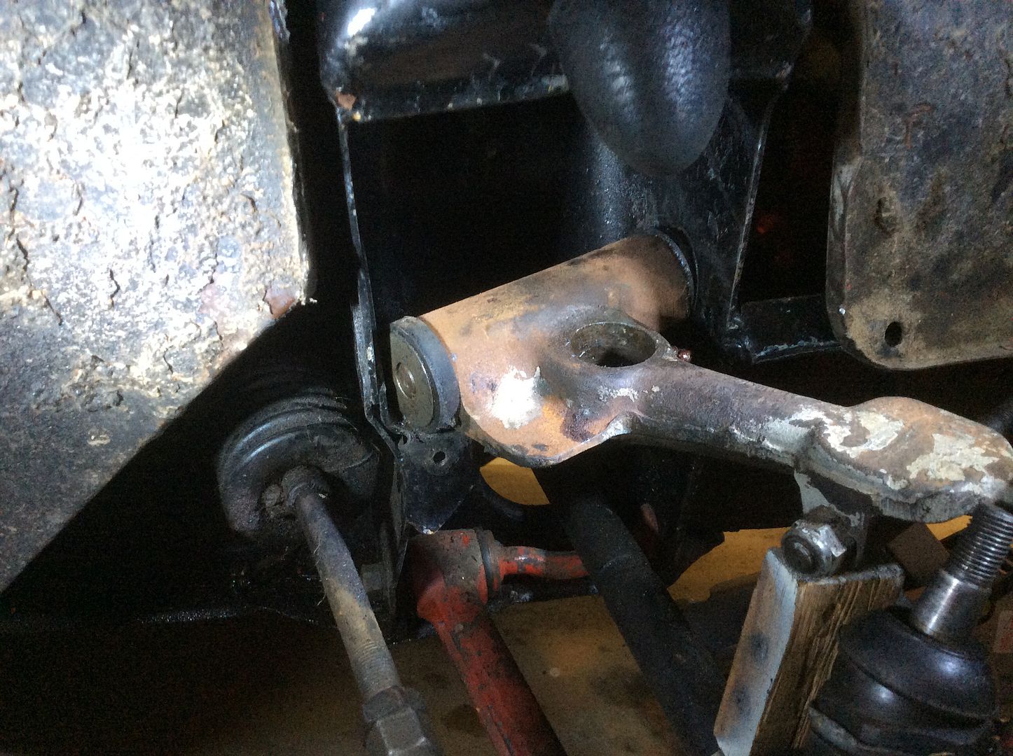

Pick up the arm and feed the shaft through the front hole of the subframe.
Push it in till the seal starts to go into the hole as well.
Like this

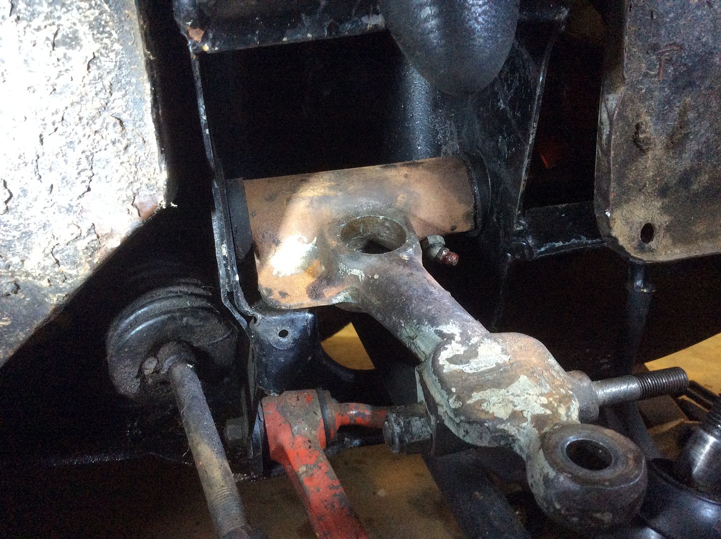

Now you can rotate it to push the back of the arm in and centre the front of it on the hole.
It should now look like this.
