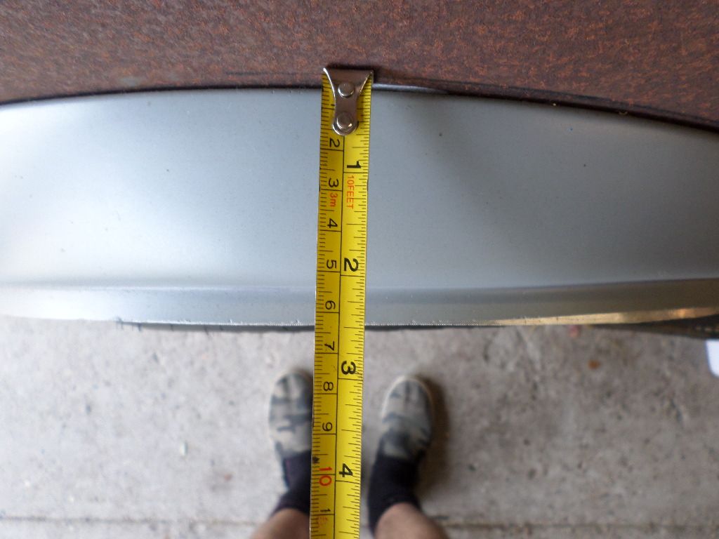

Here is a pic of my project with 5x10 new Mambas, with the wide MKII flares.

No pic? Lol. What width are the flares?

Just got it :-), width of flares would be great :-)

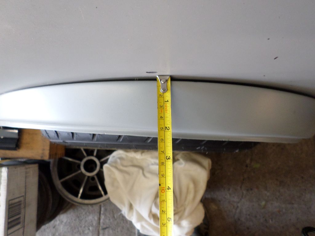

Both pics at wheel centre looking down.
Front
Rear
Scott

Just what I needed, thanks for that. Do you know if the six inch would sit out an inch further or are they a different offset? Looks like the 5 inch are good covered by 2.5 inch flares :-)

5x10 offset 0
6x10 offset -7. Sticks out an extra 20mm or so

Looks like 5 inch will be the go then :-)
