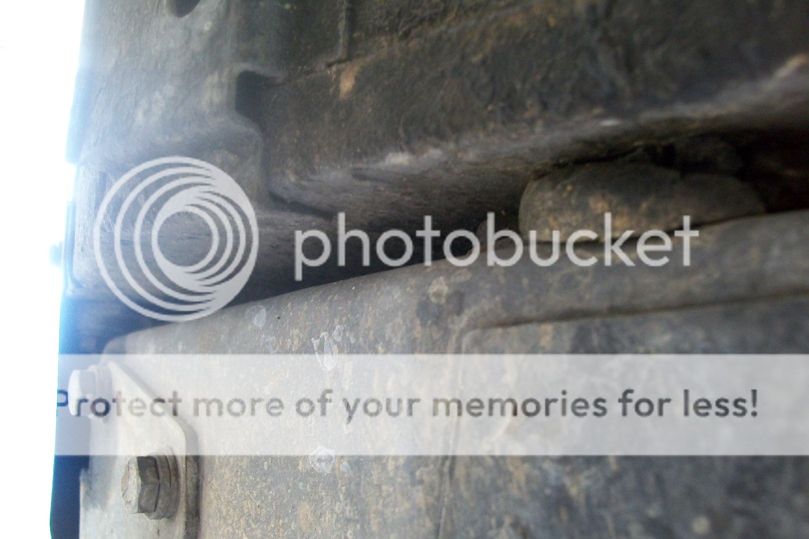

Well i put the beast up on ramps at the rear and climbed under for a look
What i noticed is what seems to be 2 extra subframe mounting rubbers located at the front of the subframe
As in just in front of the fuel pump and same other side
they look like the flat bump stops i see for sale at various online dealers http://minisport.com.au/mini-hydrolasti ... und-rubber
Are these original or has someone fitted them
1970 MK2 Cooper S

PostPosted: Sat Dec 12, 2015 10:56 am
Posts: 196
Location: Brisbane - south
Never on the outside of the subframe!
You are right they look like the trailing arm rebound rubbers but they should be on the inside of the subframe facing the rear of the car - they are there to stop the knuckle mount of the trailing arm hitting the subframe.
I was also getting an occasional clunking sound from directly behind the drivers seat. I looked and looked and eventually discovered the subframe mounting rubbers had disintegrated. If you have the car jacked up I used a small prybar and levered the subframe in various directions and it became pretty obvious they had failed.

PostPosted: Sat Dec 12, 2015 11:35 am
Posts: 425
Location: Sunshine Coast, QLD
I had the rear end up on ramps then jacked the rear of the car up to lift the wheels off the ramps
I looked everywhere and like you said i used a prybar and worked the subframe near all the mounts
Not one bit of movement anywhere
Everything looks as it should for 45 years old
Suspension moved nicely
No slop in the trailing arm bearings
Did notice the battery cable sloppy in the grommet and this must be causing petrol fumes leaking into the car when i fill the tanks up as 1 of the breathers is right next to it
