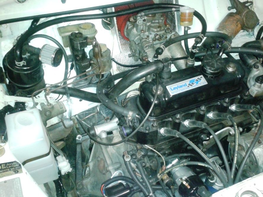

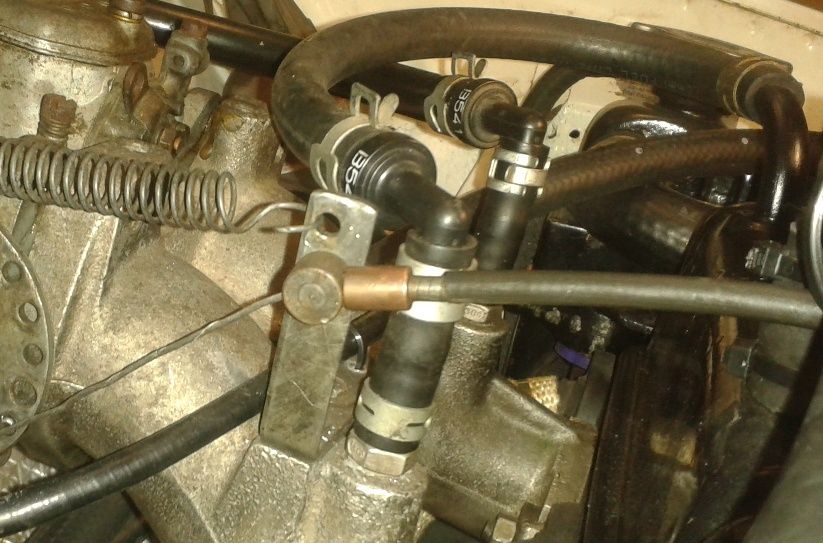

I run a small balance tube between the 2 ports. I have a Toyota PCV in one side and the brake servo in the other. It works fine, haven't seen any power loss. And it idles much better than with the PCV on one port only. Carby is a 45DHLA Dellorto (similar to a DCOE).
The other pipe coming from the left is water heating, as I had a carb icing problem @ 110KMH when cruising.
Here's another I did recently, with a 40mm Dellorto:
