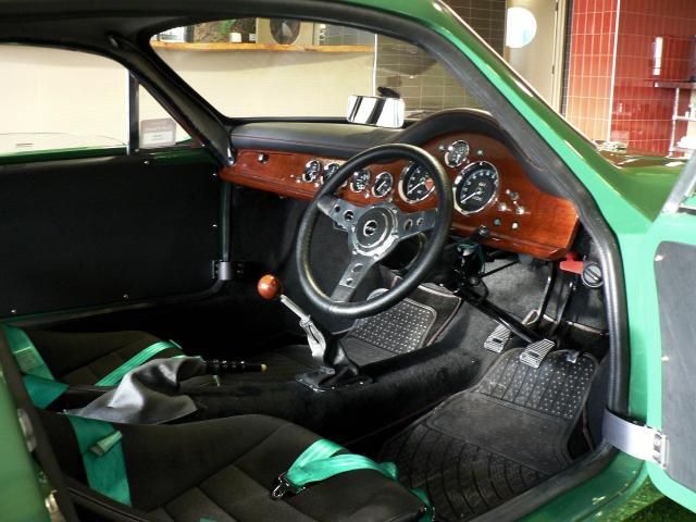

I bent a Cooper S one back about another 5 degrees to suit the driving position in the Marcos. Do it cold - don't heat it up because you may damage the rubber bush, and don't bend it too far or it will interfere with the handbrake :oops:
Curly
