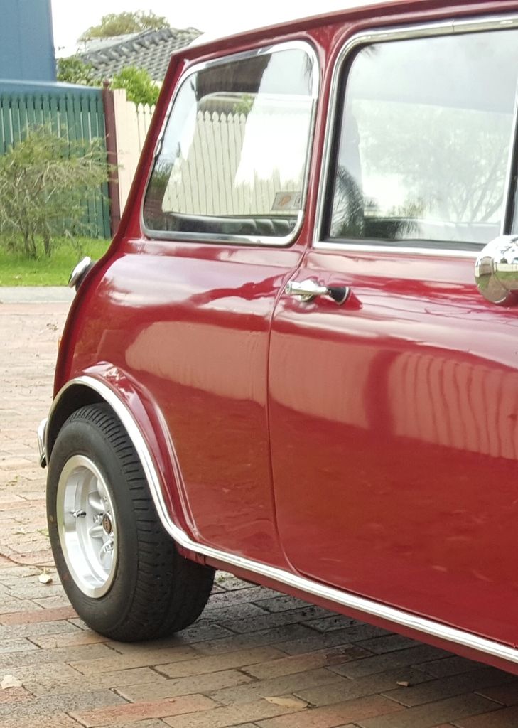

This is the current height of the rear:
I'm worried if I raise it much more, it'll start to look a bit funny.
