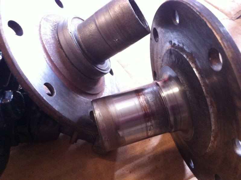

Well 45 minutes this morning with a BFH and a punch and..
The part you have on the drive flange Turn it over and check for wear I think it may have some grooves worn in it
