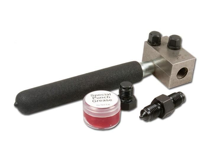

Posts: 860
To revive an old thread.
Has anyone used a Draper hand held brake flaring tool or similar?
Only does 3/16, but that's all I need - probably do two or three Mini's with it.
About 1/3 the price of the Eastwood, or $250 towards other bits for the Mini.
Any comments on them?
