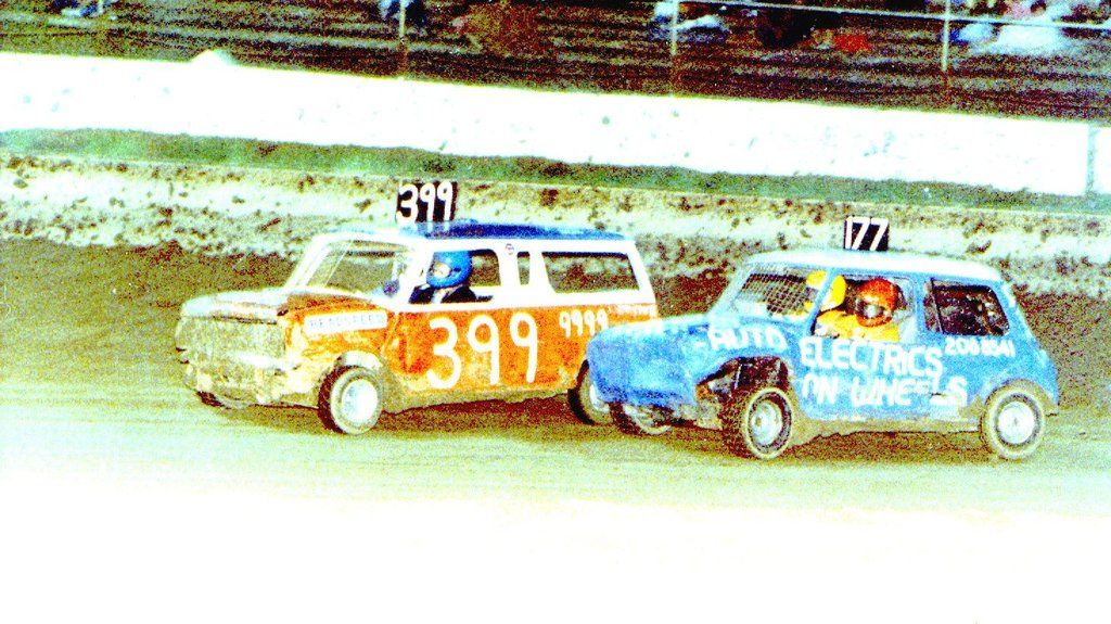

this is me & Marly over taking & puttin a lap on Tony & viv (convertablemini on here) Image :-)
notice the race number is (sort-of) our phone number too :-)
& of course we won more than just about anyone else out there :-) :-) :-)

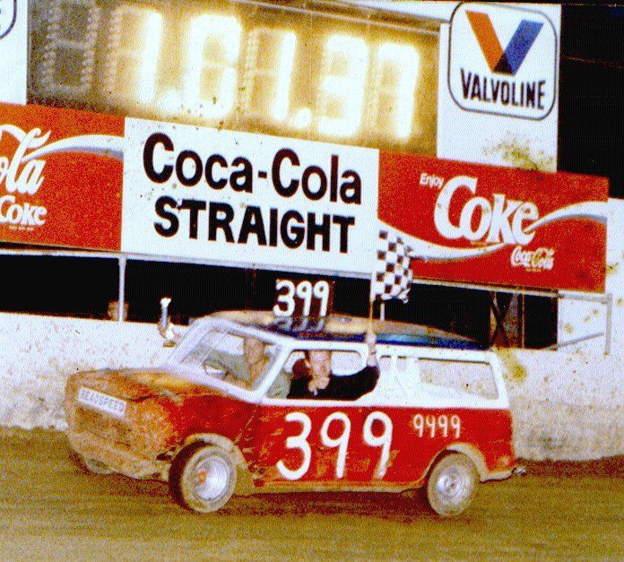

PostPosted: Sat Feb 20, 2016 1:59 pm
This one is an old Aussie factory converted wagon (from a van)
we sold this to a friend of mine (hope to get it back one day)
& ended up with a clubman front & such, but anyways, it was one of ReadSpeeds old delivery vans for years n years & then my brother had it for a while then my mate got it & the whole while it was raced in morokhanas, autocross, hillclimbs & Lakeside circuit sprints
this thing has also done sooooo many trips to Melbourne & back it would make you all dizzy
still going but parked up waiting for me to grab it back off him :-)

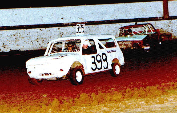

PostPosted: Sat Feb 20, 2016 2:04 pm
anyone care to have a go at racing this mini van ??? :-)
this was an old "Royal Brisbane Hospital Ambulance" ,,, eventually turned into a "laundry van" for within the grounds of the hospital for years,,, there were 5x of these if my memory serves me correctly,,, but dad ended up buying this one after the hospital wards-men were racing them around the hospital grounds & crashed this one into a big pole,,, we fixed her up & ran it as a delivery van for years & also a lunch van for race meetings :-) now gone to the big mini scrap-metal yard in the sky sadly :-(
