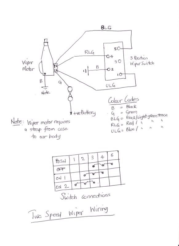

So I finally found some time to pull the motor apart, The ring was rusted away and one of the contacts had snapped off, replaced those. now i put it all back together and it still isnt parking (working fine apart from that), I pulled the switch out and found it only has 3 connections with a 4th hanging loose. I saw in a picture somewhere that there should be 4 connects to the back on the wiper switch (2 speed motor) and there are only 3 spade terminals on my one. could someone confirm I need a new switch from the photos before I order one.

Does this help?

Yep that is perfect, thank you. Looks like I'll be ordering a new switch and wiring it up properly.
