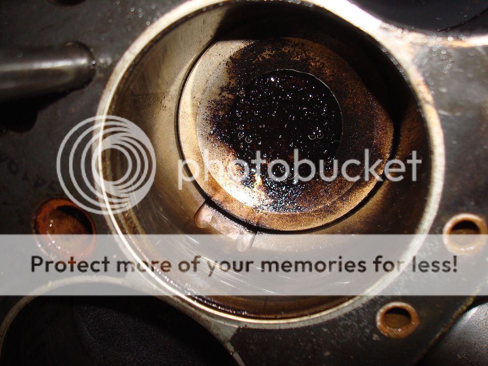

Well,
After taking the head off my Mk2 S found the following "groovy cylinder". Looks so neat and tidy it almost seems that it was there from new......
Would anyone have any idea of the cause of this? Guess a full rebuild on the cards....credit cards that is.... :(

Gudeon pin would be my first thought

Definitely gudgeon looks like a resleeve

Mate if your rods are press-fit on the small end then they are probably stretched oversize hence the reason your pin has moved. Sorry but not only do you need a new block but a new set of rods too.

Block can't be saved? AFAIK is original engine....... :cry:

Yes it might be able to be saved, as mentioned above you might be able to re-sleeve (or re-line) the block, you'd have to get it checked out

Depending what the bore size is now, boring that cylinder and fitting a liner should fix the bore. But the piston will be trash too.

yes definately a gudgeon pin move,,, but i`d bet the rod is bent from possibly6 a previous head gasket blow, hydraulic locked (filled with water over night & tried to start it in the morning type thing)
& bent the rod in the process (just a tad)
once a rod is bent it will tend to allow the gudgeon pin to wander "down-hill" & score the bore
i`ve seen them on both sides of the bore in some cases where (obviously) the rod has just lost all will to stay straight & is then all "wobbly" (for want of a better description,,, maybe "Jelly" would be a better word :-)
anyways, very typical of a bent rod... sorry to say, but yes probly be able to fix with a sleave job
not cheap but might get away with just the one sleave :-)

Good news,
Just got an email from the great GR himself, and it can be saved! :D
