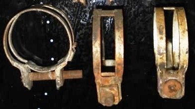

Hi Guys needing help with the correct radiator hose clamps for mid 69 Cooper S. When did the wire type clamps finish? Where might i be able to buy the correct clamps?
 Post subject: Re: hose clamps
PostPosted: Wed Mar 16, 2016 2:03 pm
Posts: 5123
Location: The Internet
Utilux No H510 and 1 1/4" diameter. They are very hard to find. The change over was 67/68 from the wire clamps.
Aftermarket ones are made for the Ford and Holden guys but they are either too big or small and have a thicker section of metal between the straps. https://www.rarespares.net.au/rarespare ... uct=CS1003
Edit- H510 in the catalogue above are different to the ones used on our cars. The correct clamps have raised edges to retain the nut instead of a single tab
