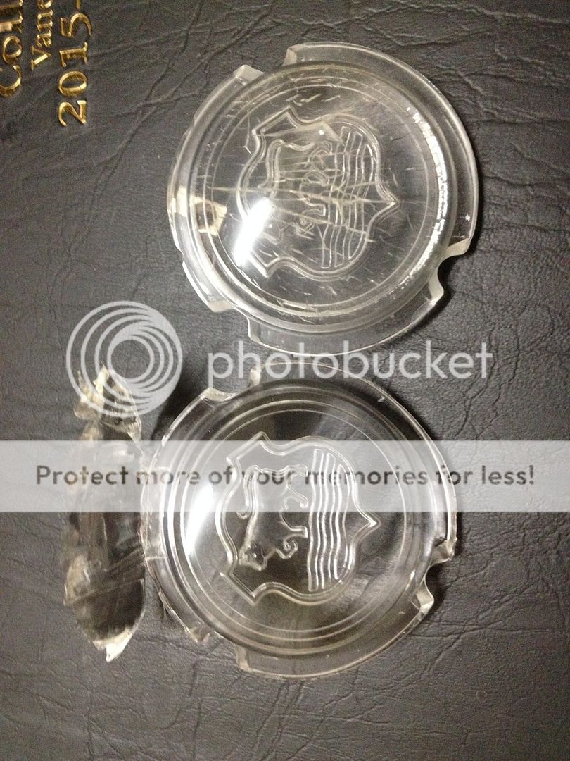

Hi guys, just put my order in for wc782 casting resin, water clear uv clear polyurethane.
I'm going to have a go at recasting this badge and any other badge anyone might need. Will also be posting the process in this thread as a 'how to' for anyone who is interested.
Wc782 is regarded as one of the best water clear casting resins that is also uv stable, so I should get a good long life out of the castings.

I cast the mould today. It took a good impression, vacuum chamber is a bit hacked together, works OK until it sucks a seal in.

Hi Guys,
Sorry Iv'e not been updating on this, the rig I was using was turfed (cracked the shits with it leaking, was a pressure pot I was asking to deal with vacuum) So Iv'e built a new one, especially for this resin where I can apply vacuum, pressure and heat (while under pressure) so I can cure this resin optically clear.
Photos attached, the lump at the top is the sprue.
Observations :
This Repro badge for whatever reason is slightly larger that an OEM badge, so it is snug in the surround, however very minimal sanding fixes this (they should be hand polished before fitting at any rate as the silicon is so accurate it picks up the microscopic scratches in the acrylic)
The Urethane is more or less the hardest Urethane available that is UV resistant, that said it is still less hard than the original acrylic. I have to do a small experiment regarding how this badge will fare in the full Australian sun but I am confident it should be fine.
It is more chemically resistant that most Urethanes, which leaves us some options regarding colouring.
Now, I can offer these for sale, but I have no idea what a Repro should be worth, especially considering they're not colored (I am attempting to do this) and there is basically Nil NOS stock of these available, or even ones in decent condition. I can cast your badge (you pay for the silicon around $40) or you could buy a cast from my badge.
I can teach anyone how to make one, but the cost for a single unit just isn't worth the hassle unless, like me, you are into this sort of torture. To make one you need basic tools, some knowledge of resins and moulding, respect for pressure and vacuum and a little electrical know how. The rest is cold hard cash.
Be aware though, I make no claims of longevity, as unlike the originals, this one is brand new.
