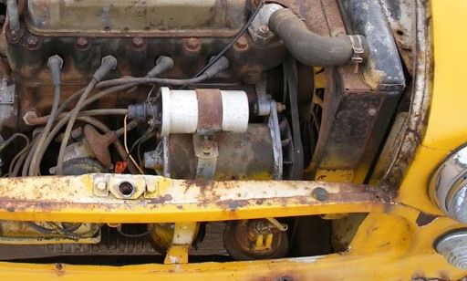

I'm interested in mk2 1970 s cars horn location I have seem them on the slam panel but mine is on the inner guard drivers side, no holes on the slam panel?

Probably not relevant but on my 1970 Mini K horn was bolted to subframe next to oil filter (Davem).

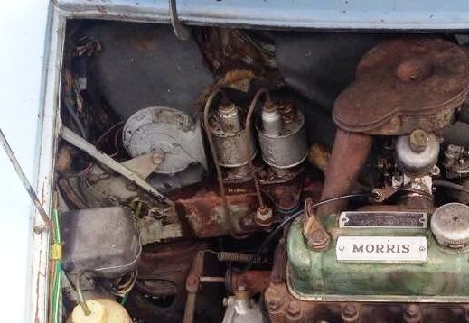

Thanks for your replies. This much I do know (I think):
1. The original horn for the early '66 came with a flat bracket bolted to it, so it has to stick out somewhere into an open space - as per Goldbrocade.
2. Mini K were under oil filter on front subframe on an 'L' shaped bracket. They even used wiring extensions to reach down there.
3. Mk2 Ss had them on an 'L' bracket to the close panel

The vertical oil cooler would rub on the horn if it was placed in the area where the deluxe had them.
I believe the horn was moved from the gusset area because of the hydro hose. The 850 had them there.
So the other logical place would be somewhere between the brake servo and the vertical slam panel brace. There were 2 x 10-32 studs on the slam panel sticking out to the rear but I don't believe they were used because of size and weight issues. I do have photos of horns tucked away in front of the servo but can't confirm how they are attached.
