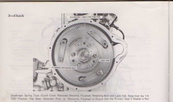

This is the Fly wheel...Trying to find out were to line up the 2 "A" marks.

I bet someone has had the centre out of the flywheel and refitted it in the wrong position.
It looks 180deg out to me.

PostPosted: Fri Apr 08, 2016 10:22 pm
Usually the slot in the flywheel is at the top when pistons 1 & 4 are at TDC.
The A mark on the backplate and the diaphragm go to that hole.
As I said in that pic the flywheel outer is fitted 180deg out if it is at TDC.

With this Fly Wheel and others I have, moving the centre, will not change the casting of the fly wheel.
The TDC marks and the three holes for the pressure plate are fixed on the one plate.
I have fitted it as I think is right.
Thank you for your input.

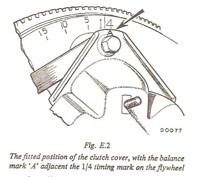

A pic from an old workshop manual I have...

[quote="Drewie"]A pic from an old workshop manual I have...
Thank you for your reply...BUT...Your Flywheel Picture is a different Flywheel to our Picture as the timing marks are in a different place.
