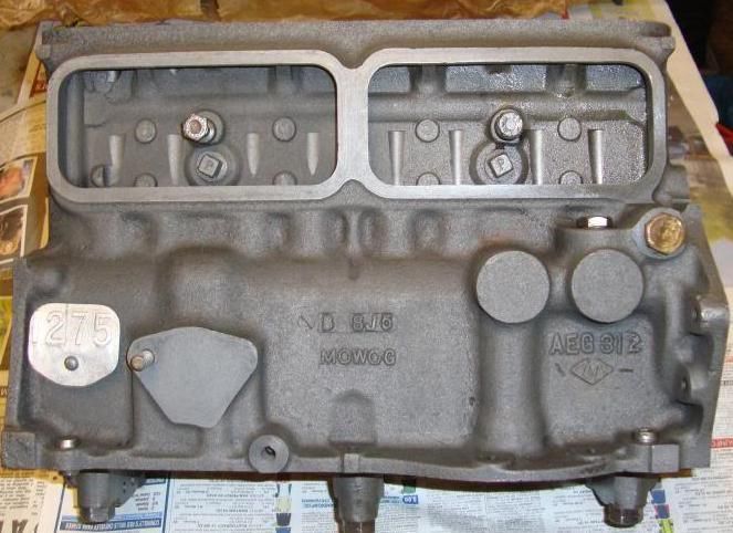

Make sure you don't just go off the engine number stampings for Identification. Many engines have been restamped and some cooper s numbers have also found their way onto an 1100S block.
The casting number "AEG312" is a MK1 S 1275 9FSAY engine. It also has a thin flange where it bolts to the gearbox and rear tappet chest covers.
The casting number "AEG312 / AEG634 is a MK2 S or early Clubman GT 1275 9FXEY engine. It has a thick flange where it bolts to the gearbox and rear tappet chest covers.

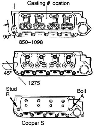

Here is a cylinder head guide if you can't find any markings on a head or if your markings don't come up on a search.
You will notice the position of the heater tap and thermostat studs change from small bore to big bore.
PostPosted: Tue Apr 12, 2016 6:03 pm
Posts: 728
Not all thick flange blocks have both the AEG 312 and AEG 634 part nos on them.
I have a MK2 S thick flange block with the 9FXEY engine prefix that only has AEG 312 cast into it.
It seems that all S blocks, either thin or thick flange, used the same AEG 312 number.
I saw a block at Link several years ago that had both numbers cast into it but it had never been used. It was thought to be a "spare part" block. IIRC it was painted black.
The pic of the block with both numbers doesn't appear to have been used either and it doesn't have the hole for the push rivet that attaches the 1275 tag.
