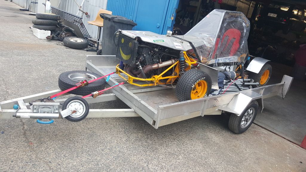

we made an Alloy one, 170kgs

I have just finished building tis one. https://www.facebook.com/photo.php?fbid ... =3&theater

Wow that's light mini man. I couldn't acces the photo convertible mini
