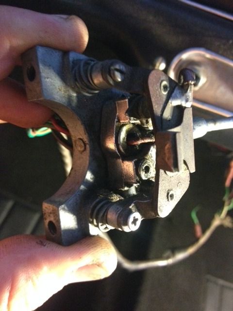

What am I missing in there my cancelling doesn't work.
I'm know I need a bit of curved steel for the 2nd cancelling on the bottom is there meant to be a spring in there??
Anyone got a pic of a complete one.

Do you have a small special shaped bolt in your steering column?
As your wheel turns the bolt nudges past the indicator and then on return as it hits it pushes it back to neutral.

That switch looks like it has parts missing where the self cancelling bolt makes contact with to push the switch to the off position. I can email you a close up Pic of what a new one should look like in that area. PM me your email address.

I do have the cancelling bolt it looks a bit trashed . I am missing the cancelling peice on the bottom just thought there may have been a spring or something else I'm missing.

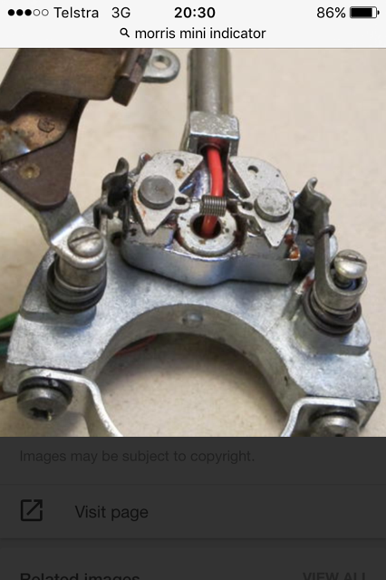

Went through a few sites surprised I found this but shows what I'm missing ... One canceller & small spring . Might be able to get the spring from an old fishing reel will have to make up the missing peice .
Funny I think I remember seeing it ages ago didn't know what the hell it was .... Don't throw much out but that may be gone .
Thanks guys .
