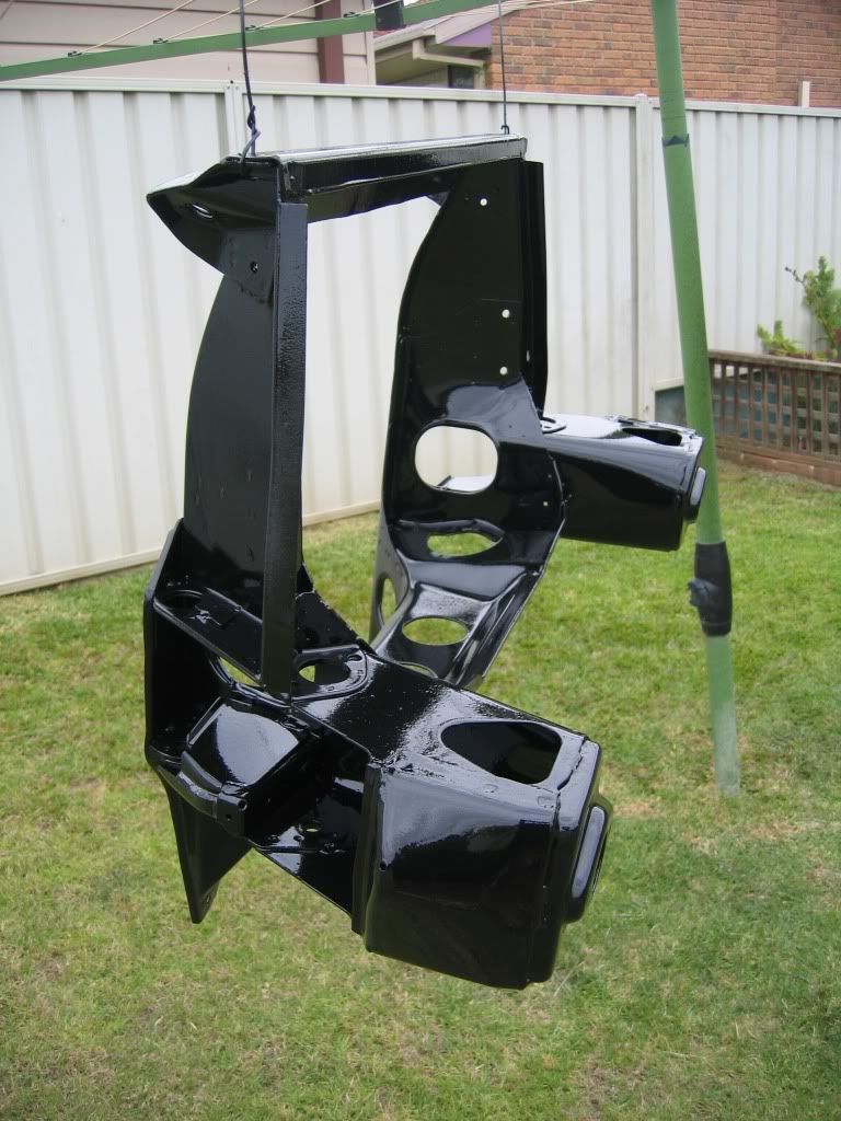

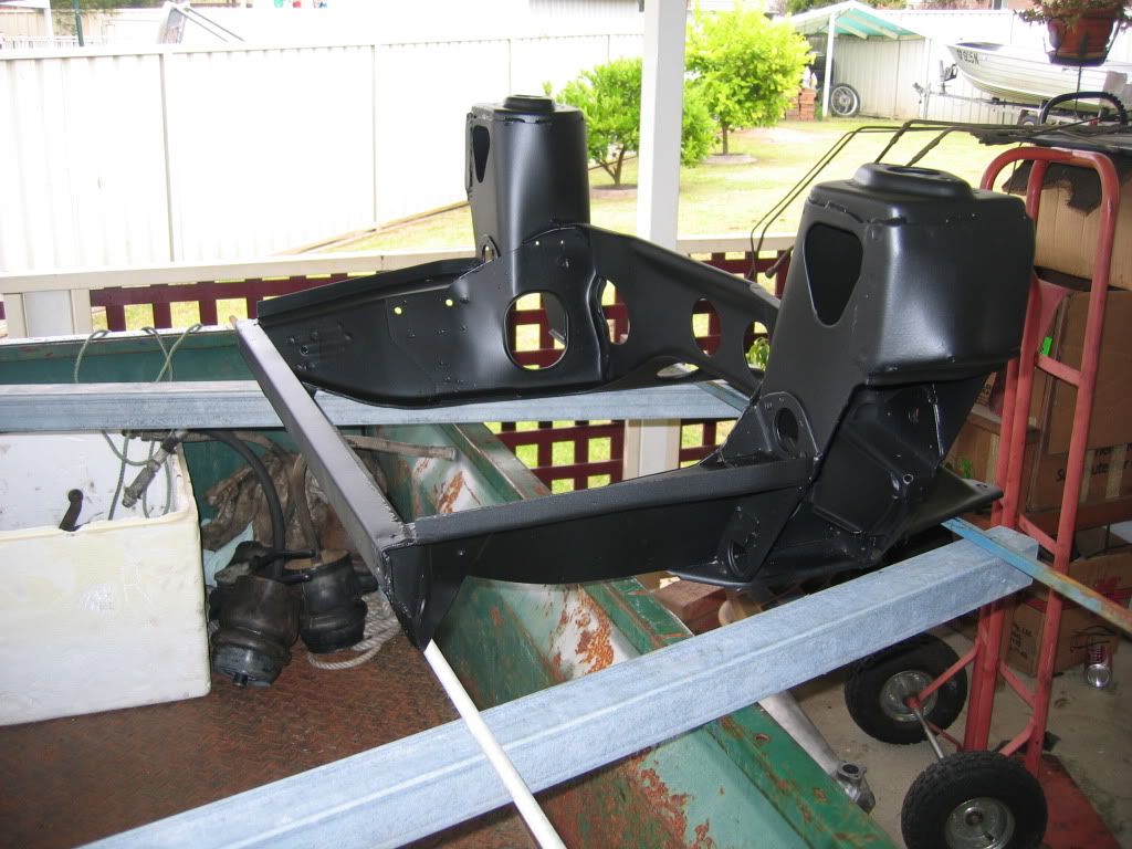

I had my sub frames sand blasted
painted them with Por15 black
and then went over that with Por chassis black

Yep Slacko. They look fantastic. Too nice to hide and bullet proof as well.

Posts: 2639
They look sensational Slacko!

If you don't have access to the correct facilities to use 2k, I myself would strongly consider the POR system. Their products have an excellent reputation and you can get a really good result with a minimum of fuss.
Looking good Slacko!!! but i bet that front subframe also cost you a bag of redimix to straighten the clothes line for the missus :lol:

PostPosted: Thu May 19, 2016 8:34 pm
Posts: 850
Location: Narellan NSW
Must admit
clothes line has never been concreted in
its always had a lean on it after the kids swung on it and broke the crank handle off
the wife just has to stand on the low side to hang cloths on the line
