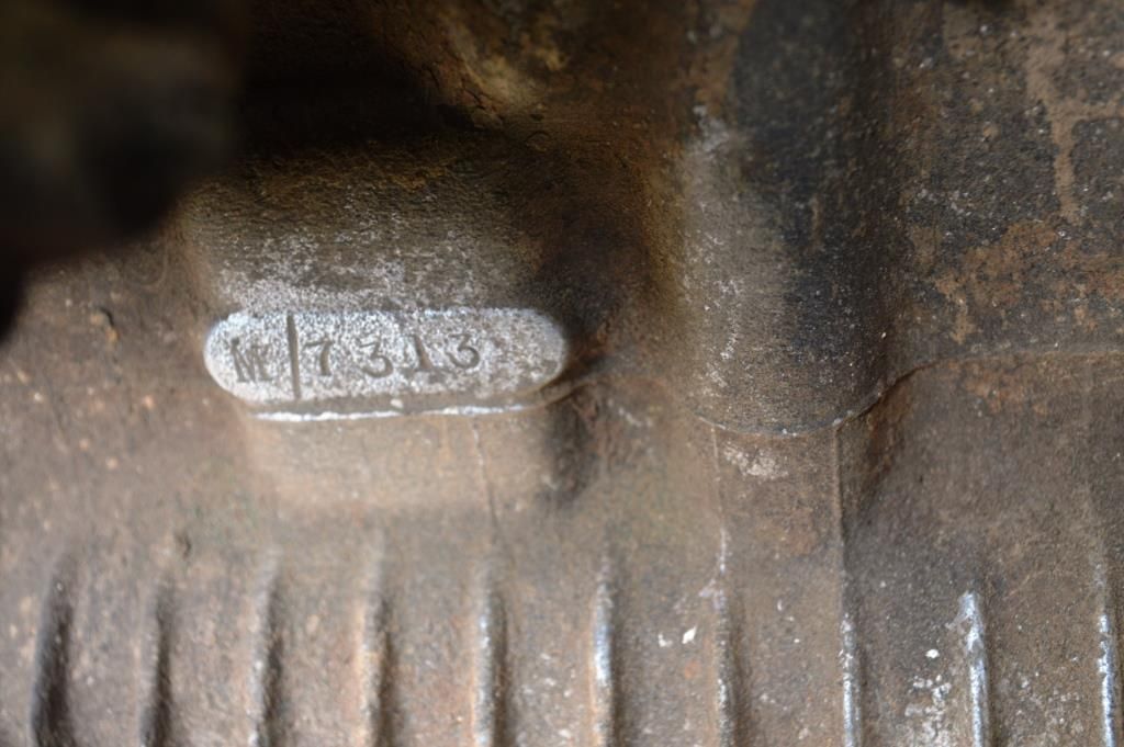

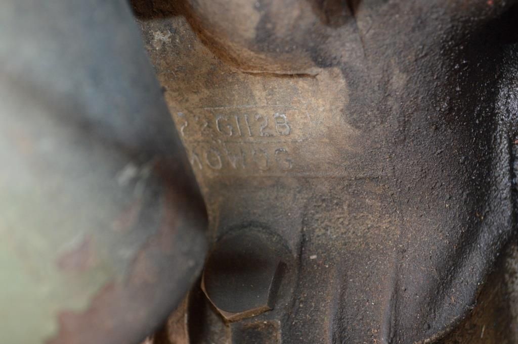

Does anyone know what the number M/7313 that is stamped on my 22G1128 gearbox indicates (if anything)?
The gearbox is fitted to a Moke 1100 motor (10YF/U/H****) and is a 4 synchro remote shift
Dave

M for moke? 7313 is just a serial number.
Here are some of the serial numbers I have found for the 4 speed, 4 synchro, 22G1128
Mini K = 1234 or 12345 or 5/12345
MK2 S = FAXE 1234
Clubman = 22/1234
Export Moke = 30/1234
Magic Wand = 21/1234
There is a little bit of info here for the UK boxes and it also gives you the laygear part numbers and engine changeover points.
http://mk1-performance-conversions.co.uk/gearboxes.pdf

Done some more research and the 1100 motor/22G1128 remote shift gearbox appears to from a late 60's early 70's Moke (as it also has Hardie-Spicer drive shafts). Apparently they came out with this combination until ~1973.
Looks like the M might be for "Moke" then :D
Dave
