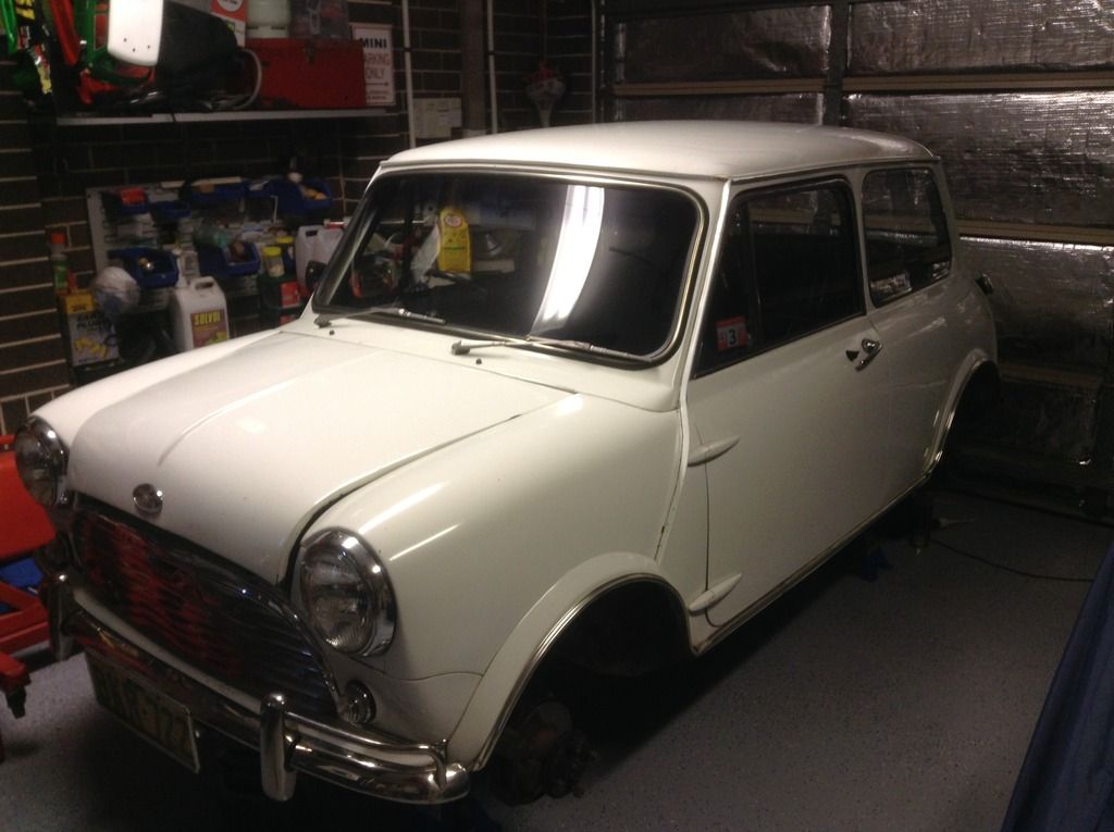

PostPosted: Sat Jun 18, 2016 2:45 pm
It is for windup windows though,
you can get the springs from minisplus in Victoria through there website
http://www.minisplus.com.au/classic-mini/product/listing?limitstart=&filter_freeform_2=door%20handle
nice mk2
