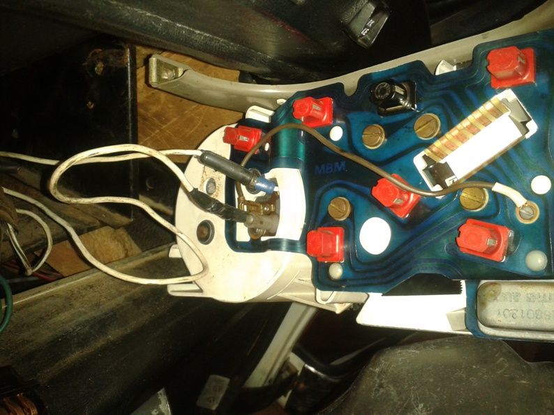

PostPosted: Sun Jun 26, 2016 1:43 pm
Posts: 5123
Location: The Internet
shnitzee wrote:
Thanks CM
Unfortunately, my brain has a lot of trouble when it comes to electrics so sorry if it's a bit of a 'duh' question but assuming the pod is a later style ('76) and I have two white wires on the harness, where exactly do I connect them?
Eiles
I had a 77 Leyland with a 3 gauge cluster. Here is a photo of the 2 white wires going to the tacho.
PostPosted: Sun Jun 26, 2016 8:20 pm
Posts: 483
Location: Perth, W.A.
Thanks Gtogree.
