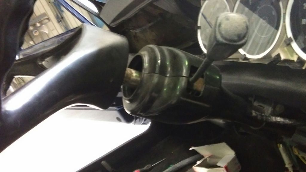

Trying to put everything back together now.
Why do I have this gap between cowl and steering wheel?
Help
Eiles
PostPosted: Fri Jun 24, 2016 11:02 pm
Posts: 1489
Location: Armidale, NSW
Perhaps the inner column isn't right on the splines of the steering rack (you took the bolt out before putting it on?) otherwise the outer column can be pushed too far down, loosen of the steering column bracket under the dash and slide the column up, it is in the right place when the 'T' bolt on the inner column lines up and cancels the indicators.
Is the steering wheel right down on the splines?

Thanks Fuzzy. :)
The outer column was sitting too far down!!
All good now.
