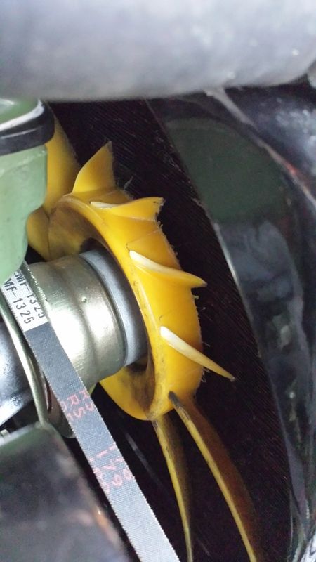

I was giving the mini a kick in the guts and then big bang and a oh F!@K what the moment this is gonna be exspensive
Found the fan has disintergrated.
has any one exsperienced this.
no fluid has leaked out which is a good sign.

Never had a plastic one lose a blade like that, but have had a metal 6-blade fan throw a blade through the radiator which wasn't pretty.

For the fan to foul cowling, the engine must have moved fore/aft within the cowling.
Check engine steady from firewall to thermostat housing. This controls fore/aft movement of the engine near the radiator.

There are different spacer widths, can't tell from that but is it too close to the radiator? As the revs rise the fan moves a bit and it only takes a touch and whamm... plastic vs metal.

My rad and engine mounts are solid. You may be on to something regarding the fan spacer. I will shave 5mm off it.

there would be plenty of evidence if it'd touched the radiator - lots of flattened fins - it probably got a little crack in one blade and it let go, taking the rest with it...

It could be that when it hit 50,000 rpm the blades flexed back towards the engine at touched the crank pulley.
Mine did until I put a spacer between the pump flange and fan to push it closer to the radiator.
You'd be surprised how much the fan flexes when it's asked to pump a lot of air.

Ps shaving the spacer wil make it worse :cry:
Pps you do realise that the plastic fans come in a number of different sizes...ie blade width?? The white ones are the widest and there are several diffent yellow ones.. I don't know if this reflects age or what....

I had a white one blow up on me recently. Took the radiator with it. Replaced with a yellow plastic one off a late 80's Japanese Rover. *Crosses Fingers*

i wont fit a white one, not at all they`re really bad for that, "renowned" for it actually
the yellow ones aren`t as bad but still not wonderfull
we have plenty of the original metal fans here that we clean & paint for std issue engine rebuilds
but for my own cars i generally fit the metal 4-blade :-)
& yes you really do need to make sure that both your top & bottom rad-cowls are spot on, both top & bottom rad brakets "suit" the situation with the correct spacer behind the fan to suit the application
there are so many combinations that people "concoct" that aren`t right ending terribly for everyone involved
one of the tricks is to obtain the correct bottom cowl half,,, there are 4 different bottom cowl-halves (that i`ve seen), not counting the later phomy "one-piece) ones & the larger 1100 type ones
mix up the wrong items or add a few bent bits & others on horrible angles, &/or the cowls being cut & stuffed with,,, ive seen a whole clusterphark of crap being fitted up to some minis & it always ends badly
get the right (old skool) stuff & have it fitted correctly
early cars have short brakets & thing steel spacers
Late cars have long brakets & thick alloy spacers
