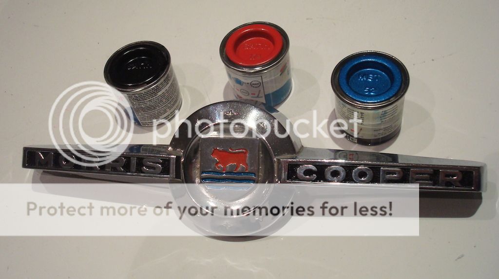

Just repainted my badge as there was no colour on it at all except a little red outline of the Ox.
Used Humbrol Black Satin 85, Red Satin 174, and the only blue close to original was Blue metallic 52
It looks better in real life than the picture.....

Bought a superfine paintbrush from the hobby shop with the paint and used a magnifying headband thingy and cotton buds and turps to wipe off any mistakes. Took about 30 minutes.
Probably the best resto job I've done so far...if only everything else was as quick and easy!
