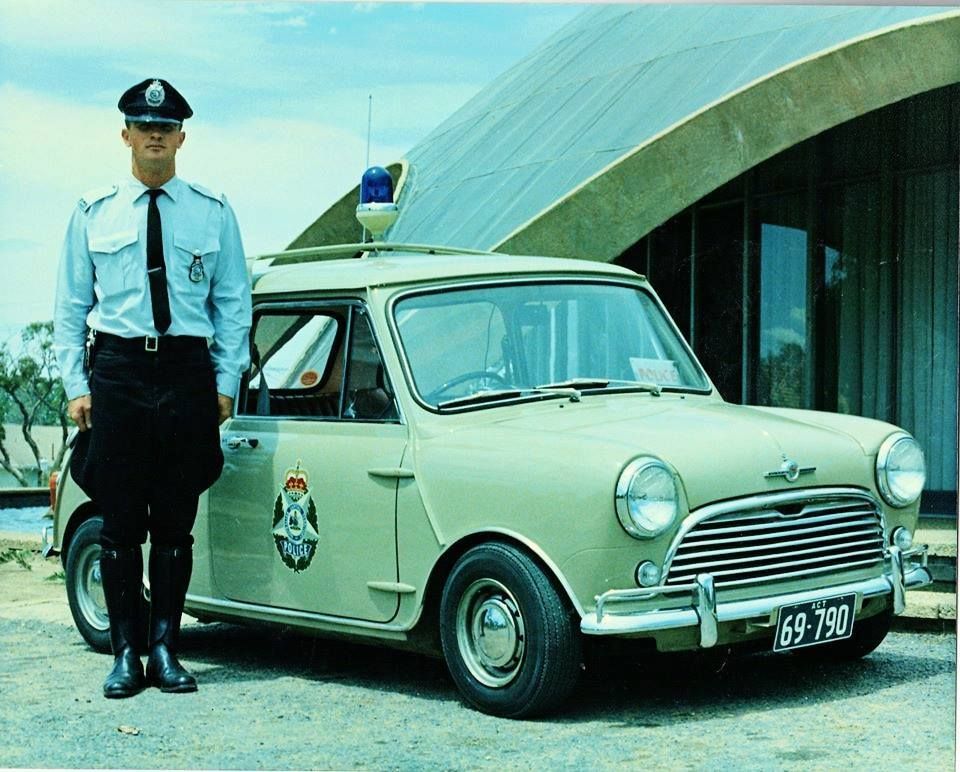

Here is a colour photo if it helps. I can't see the slam panel brace to date it. It has early pleats in the back seat.
Canberra Police got 3 in November 1965 not sure if this was one of them.

Here is a photo of one of the ACT late 65 cars. Might be the same one.
Aquajets give a period look.

It's been suggested that the tyres were perhaps Olympic G8's ?
My money is on the Olympic GT so far. There is a distinct dual zig-zag between the sidewall and tread that I can see when zoomed in on the colour photo. There is a Goodyear G8 but is not a Radial Ply.
