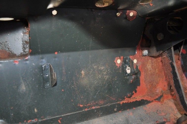

The heater J brackets were spot welded on. I believe the mounting position was the same for all the heaters except for the late 1970 beehive heater. They used 3 captive nuts.
 Post subject: Re: Cooper Heater Mounts
PostPosted: Fri Aug 12, 2016 9:05 pm
Posts: 383
Location: Cherrybrook NSW
thats what mine looks like its a cooper s 1968

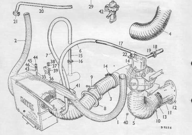

The early cooper did not have the J brackets. They had a heat exchanger bolted up to the underside of the parcel shelf and the fan was under the bonnet.

No yours is original for the Cooper S 1965 - 1969
This is the Cooper type they used before going to the Cooper S style. I don't know when the change over occurred.
