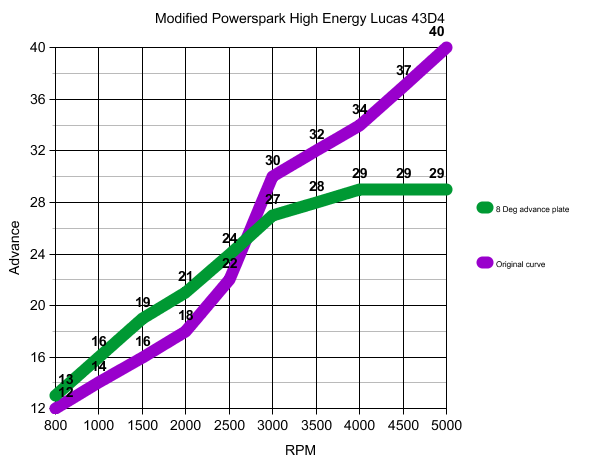

Why don't you plot your curve and see what it looks like and the total advance you are getting. You probably have a 15 deg advance plate inside the 29D which means you have to set you static advance very low or you will get pinging at the top revs.
I used a dialback timing light and measured the advance at 500rpm intervals. Just used a graph program from the net. http://nces.ed.gov/nceskids/createagrap ... 3c1ffd3e4b

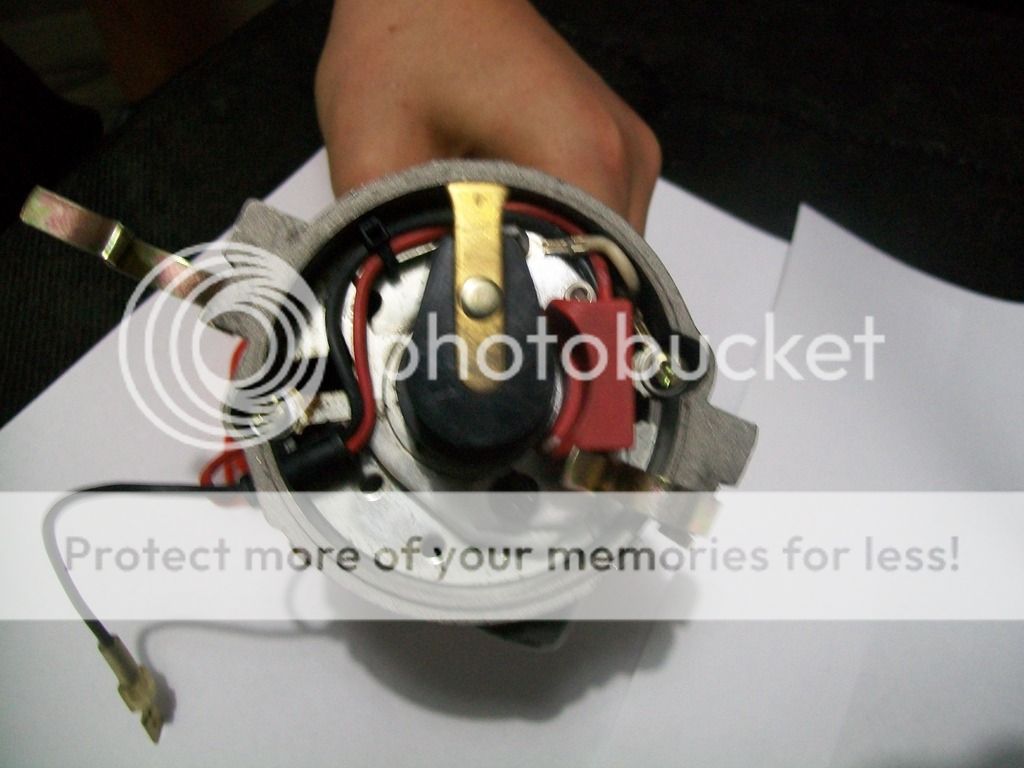

I have this dist spare but has no marking on it
Is it a Chinese one
1970 MK2 Cooper S

Posts: 5123
Location: The Internet
Looks similar the powerspark 43D4 that I bought. The advance curve from factory curved the opposite way and it had way to much advance.
I welded up the plate to 8 deg first then filed it back to 10 deg after some testing.

So does anyone have an idea what my Dist is
1970 MK2 Cooper S
 Post subject: Re: electronic ignitions
PostPosted: Mon Aug 08, 2016 5:39 pm
Posts: 4501
Location: Wollongong, NSW
Looks like a 45D style?
PostPosted: Mon Aug 08, 2016 6:32 pm
Looks like 43D (has no vac advance). Same as mine. Check number on body.
