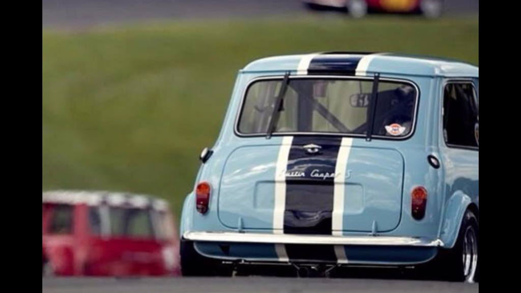

Can anyone tell me what the main colour of this mini is?
PostPosted: Wed Jun 08, 2016 7:40 am
Online
Posts: 4501
Location: Wollongong, NSW
That's a photo from stanceworks.com, which means it's had filters/editing applied to the image so might not be a true representation of the colour
http://www.stanceworks.com/2014/07/can- ... enge-2014/
The car looks to me to be Speedwell Blue
PostPosted: Wed Jun 08, 2016 2:01 pm
Online
Posts: 4501
Here is the resto blog:
http://www.toyboxracing.com/52-austin-cooper-s.html
Painting - exterior is Wedgewood Blue
http://www.toyboxracing.com/kimes11032013.html
http://www.toyboxracing.com/kimes11112013.html

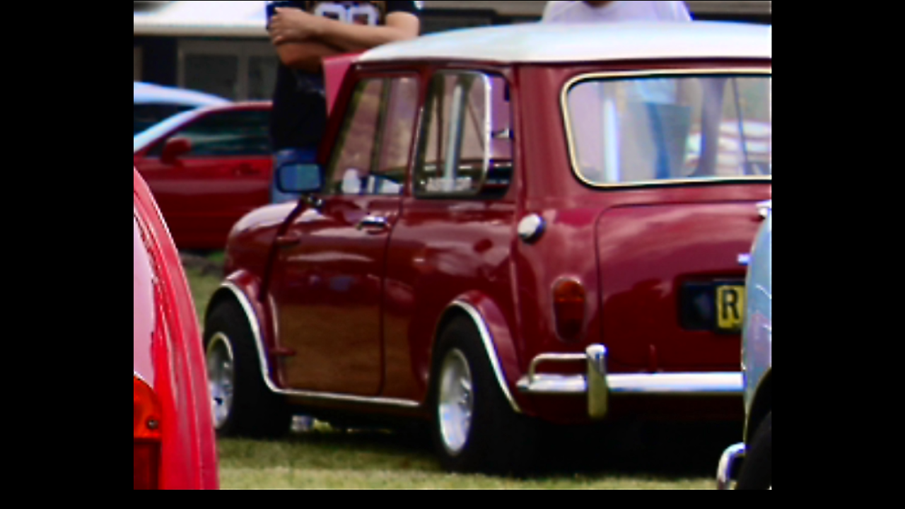

Can anyone tell me if this colour is Damask Red or not?
PostPosted: Wed Sep 21, 2016 11:12 am
Posts: 462
Location: TOWNSVILLE NQ
NOT850 wrote:
I've looked at all my Mini Magazine editions and all the minis with a black roof just says colour - black.
There is 'Midnight Black' that is readily available. A lot on vintage car restorers use it for the mudguards on the old tourers.
