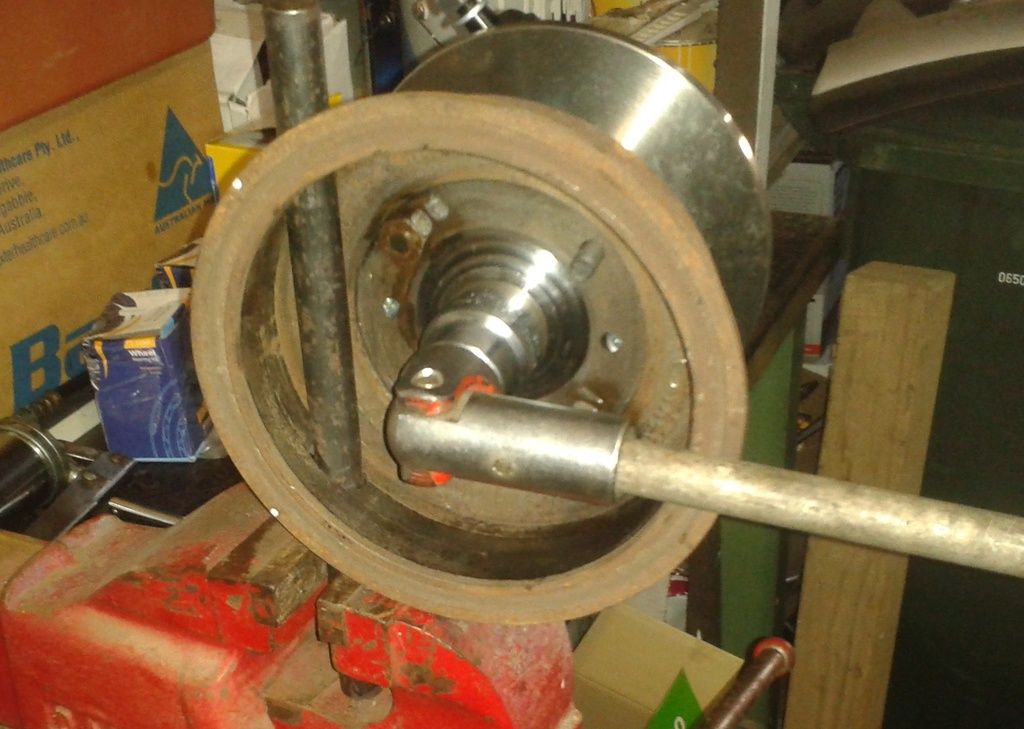

This one is for doing CV nuts and is an old brake brum with 2 holes drilled through it.

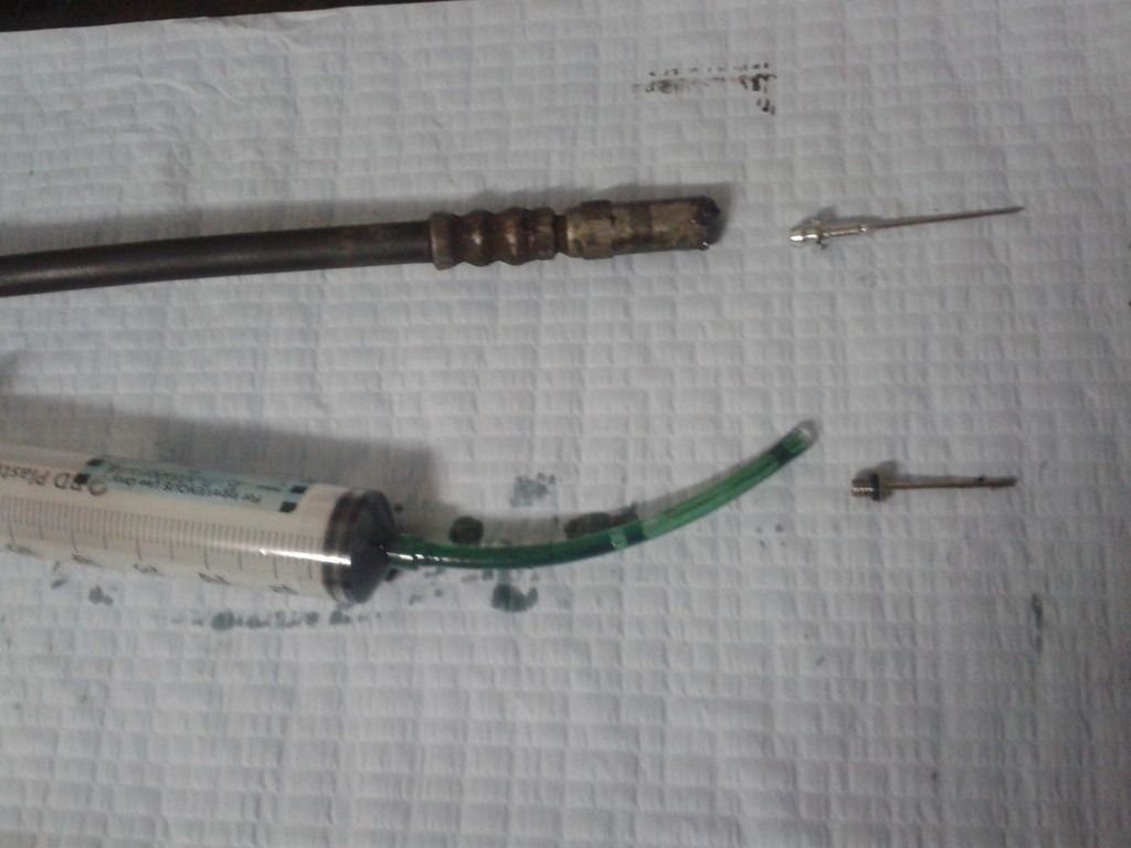

Purchased a grease gun adaptor for non greaseable ball joints.
Syringe is for putting 140W oil under the steering boots. The tip is from a bike pump for pumping up balls.

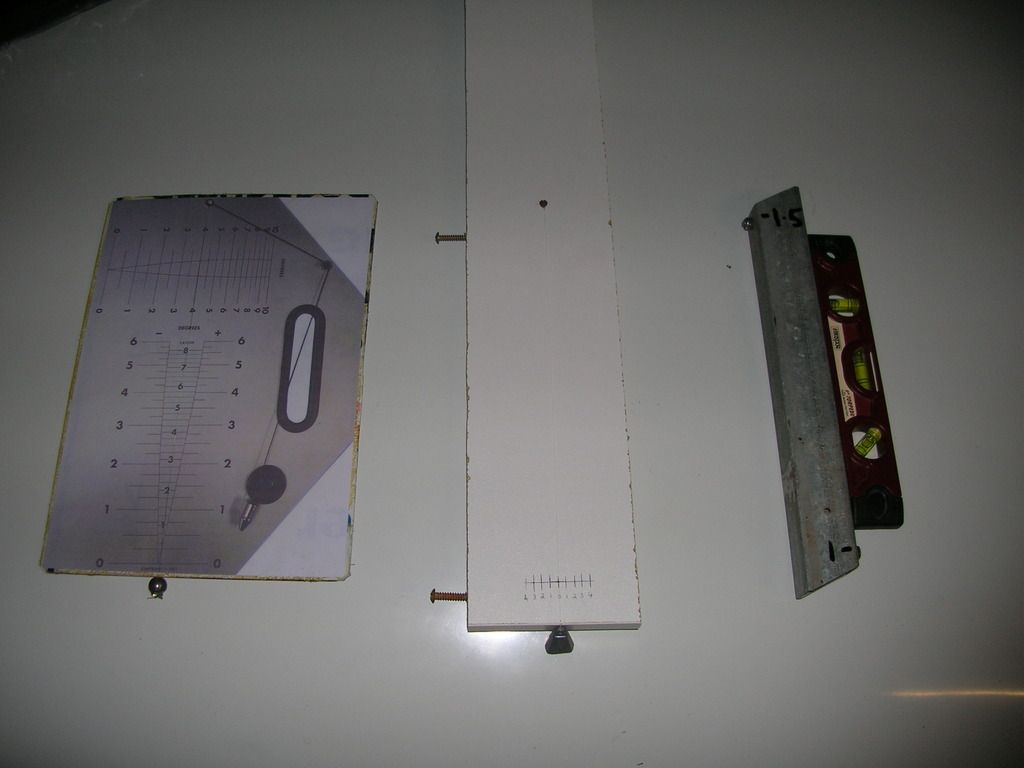

Camber / Castor Tools
viewtopic.php?f=2&t=88771&p=973165&hilit=camber+gauge#p973165

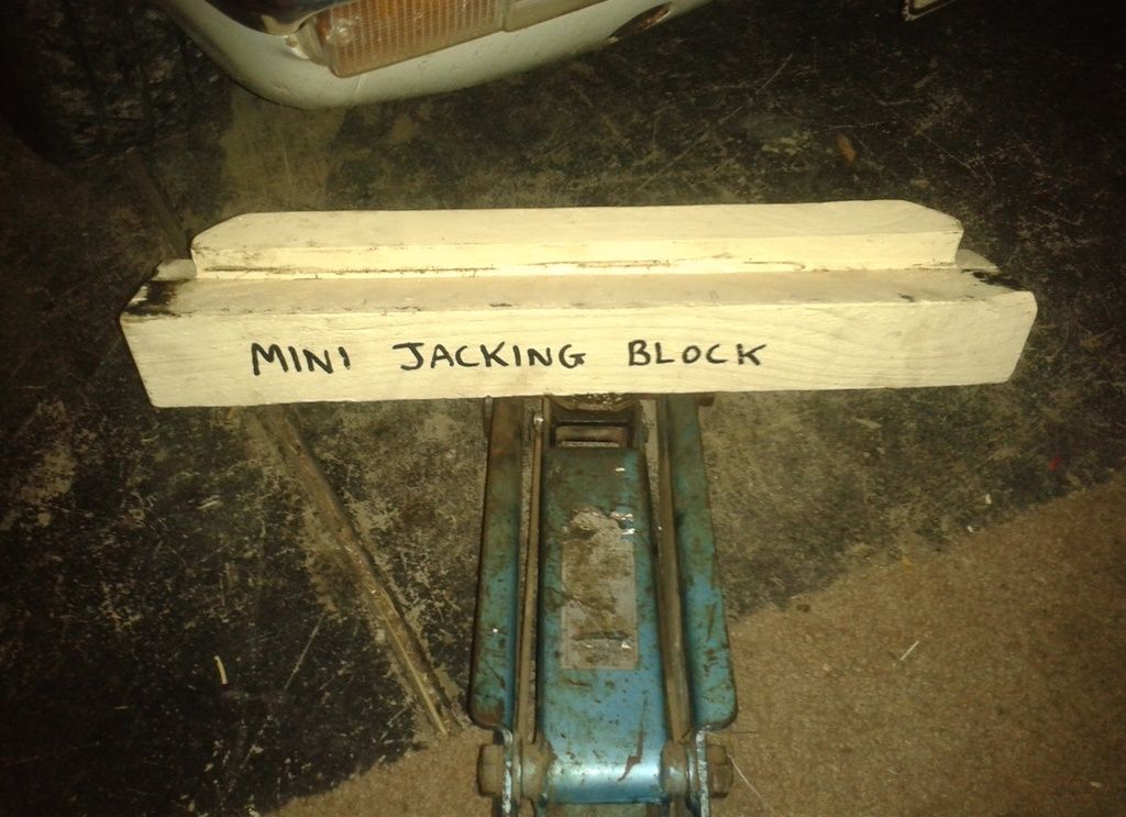

Forgot my Jacking Block, Love this thing.
 Post subject: Re: Specialist Tools
PostPosted: Sat Jul 11, 2015 9:35 pm
Posts: 648
Location: Ballarat, Victoria
Mini Jacking Block of Awesome... more like it... I love mine also, makes things so much easier/quicker
That's a pretty high tech piece of kit Brad, you got specs on that bad boy;-)
PostPosted: Mon Jul 13, 2015 7:53 pm
Posts: 5123
Location: The Internet
Here ya go. Fits into the front subframe like a glove.
viewtopic.php?f=25&t=78195
