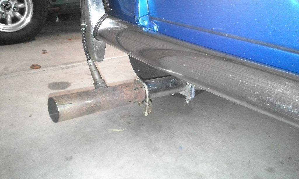

This is what I use on the exhaust. Basic but works - only down side is the need to put an extension on it to check the idle mixture to overcome the "hunting" from the cam. (I put the clamp on properly when it is on the road).

Here's mine- pipe is 1" OD, spud nut is M18.
It slips into the tailpipe.
